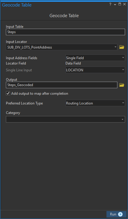

1. Is there any address information associated with the certificate of occupancy that was maintained by the Step Dept?
2. In the parcel data are the lot and subdivision values in separate fields? If so, you could probably get away with creating a locator with the Create Locator tool using the PointAddress role where you map the Lot field to the House Number field from the role and Subdivision field to the Street Name field from the role.
You will need to concatenate the lot number and subdivision fields in the spreadsheet into a single field, then use that field to geocode the spreadsheet with the Geocode Table tool. Right-click the table in the Contents pane and select Geocode Table.
