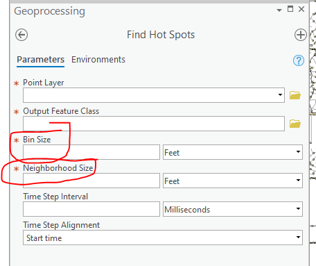

In the "Finding Hot Spots" Geoanalytics desktop tool in ArcPro what is the difference between the the parameters between "Bin size" and "Neighborhood size"?

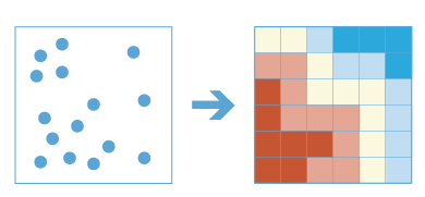

The bin size is the area you are aggregating your raw points into. From the documentation:
The distance interval that represents the bin size and units into which the point_layer will be aggregated. The distance interval must be a linear unit.
So from the image in the topic - the image on the right would have 36 bins:
The neighborhood size is used to compare a bin to it's neighboring bins:
The spatial extent of the analysis neighborhood. This value determines which features are analyzed together to assess local clustering.
The neighborhood size must be greater than the bin size. This is similar to the distance band parameter in the Hot Spot Analysis (Getis-Ord Gi*) tool works.
So with a bit of an adaptation of the Hot Spot Analysis (Getis-Ord Gi*) doc - this should help explain it:
Each feature (bin!) will be analyzed within the context of neighboring features (bins). Neighboring features inside the specified neighborhood size will receive a weight of one and exert influence on computations for the target feature. Neighboring features outside the critical distance will receive a weight of zero and have no influence on a target feature's computations.

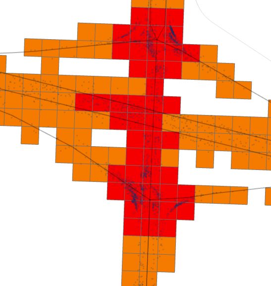

Hey Dan thanks for your response.  I have a little better idea of the difference now between Bin size and Neighborhood size.  You are correct, in that I am like many users who do not have a statistical background in statistics.  However, after a few iterations of various bin and neighborhood sizes, the data points, (which are car accidents in the City of Overland Park, KS) seem to align more accurately with the bins.
