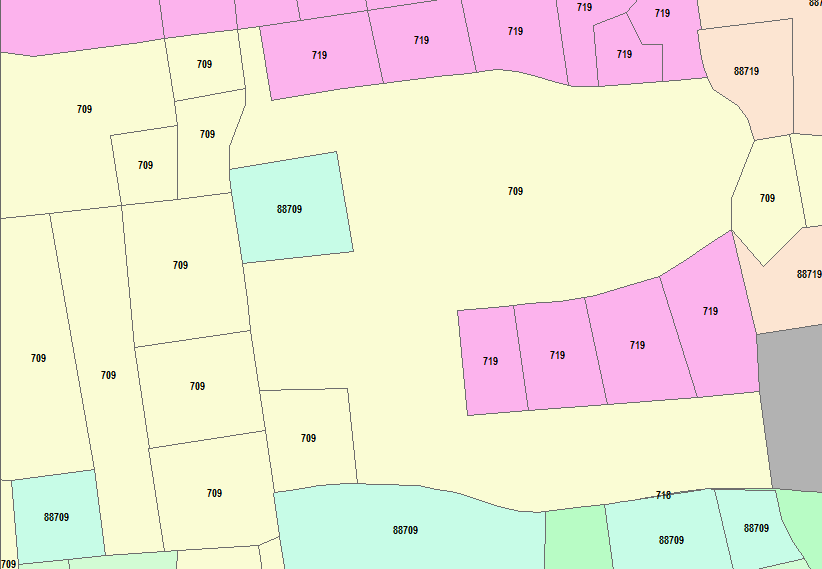

I am looking for a way to calculate the distance between polygons that share the same attribute information.
For instance in the image below, I want to calculate the minimum distance between all polygons labeled 88709. So for this number, I would need 4 distances per polygon. I would also want to do the same for all those labeled 719 (9 distances per polygon) and 88719 (3 distances per polygon).
I am trying to find polygons in a feature class that have the same ID number but are far apart/not directly adjacent to each other. So in essence, island or orphaned polygons for lack of better terminology. In the image below, I would want to change the ID number for the 88709 polygon in the middle as well as the one in the lower left. I tried using the centroids and then doing a closest facility analysis but that does not produce the results I am looking for.

Take a look at the Near tool; you are licensed for it.  Since you have multiple features that share the same id this is going to be a challenge for you;  you might want to create a summary table on ID to get a handle on how many multi-listings you have.  That might give you a method with which to iterate through with the near tool.

I have 255 ID numbers that are duplicated somewhere which makes 1,376 total polygons. I have also tried the Near tool but the issue is that the output does not tell me exactly which polygons are the ones I need to compare. I am thinking that I need to build a model of sorts that iterates over the ID number and calculates the distance between all polygons with the same number.
That's why I suggested iterating through the list of duplicates id's.
Simple Psuedo code might look something like:
Select polygon-id = ####
Perform Near on selected polygons
Look for the polygon oid that consistently has the greatest distance
