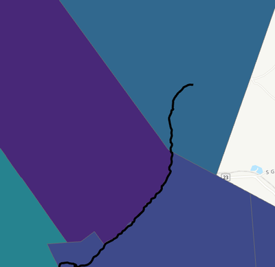

I have polygons and then polylines. As shown below:
I want to create an adjacency matrix that shows which polylines touch each polygon. Where the rows are polygons and the columns are polylines.
