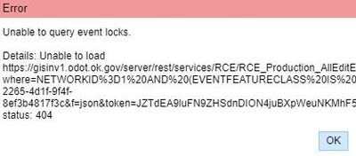

We recently starting running into an issue where running a Select by Attribute Query in RCE will sometimes return a Status: 404 error. We have tried clearing cache and changing browsers, but we can't find a common theme that will trigger it or keep it from happening.
Has anyone run into this? Is there a query size limit in RCE? Thoughts?

I do not remember the exact error we had but we ran into query length issues and had to modify the web.config on the web adaptor RCE was hitting.
https://support.esri.com/en/technical-article/000015245
brian
<system.web>
    <!-- 8/12/20 bb https://support.esri.com/en/technical-article/000015245 -->
    <httpRuntime maxRequestLength="2097151" maxQueryStringLength="2097151" maxUrlLength="2097151" executionTimeout="100000" targetFramework="4.5" />
    <!-- <httpRuntime maxUrlLength="2000" maxRequestLength="2097151" executionTimeout="100000" targetFramework="4.5" /> -->
</system.web>
<system.webServer>
    <security>
         <requestFiltering>
	    <!-- 8/12/20 https://support.esri.com/en/technical-article/000015245 -->
            <requestLimits maxUrl="2097151" maxQueryString="2097151" maxAllowedContentLength="2147483648" />
            <!-- <requestLimits maxAllowedContentLength="2147483648" /> -->
         </requestFiltering>
     </security>
</system.webServer>
