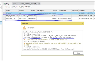

Hi,
I was wondering if anyone ran into Error 003576 when posting from an editor version to Default version on ArcGIS Pro 3.1.
Default version is already set to be Public so I'm not sure where I set the permission wrong.
Thanks!
2 Solutions
TingWang1
Looks like I found the cause - it was because I didn't run "Apply Events Behavior" after edits. After I run it, I was able to post.
The error msg is odd though
TingWang1
Ryan - At beginning I was using the right-click "Reconcile/Post" function from the "Manage Versions" window, that's when I got the error.
But when I switched to using the "Reconcile" button and "Post" button directly from the ribbon, it gave me a meaningful msg that I need to run "Apply Event Behavior".

TingWang1

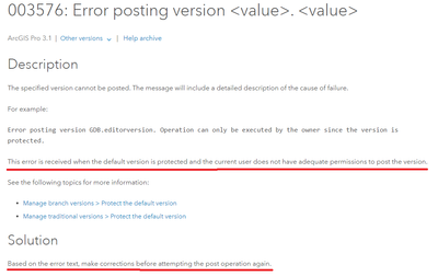

MarceloMarques
003576: Error posting version <value>. <value>—ArcGIS Pro | Documentation
