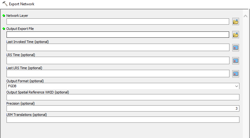

AmitHazra
Hello Colin - Export Network is expecting up to 9 arguments:
When you open the parentheses on the tool it should look similar to:
-Amit@Esri
