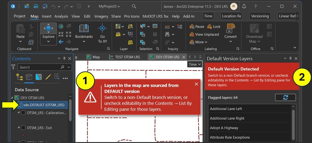

Default Version Guard scans the active map in Pro and provides visual notifications.
  1. A prominent banner appears in the map window indicating that features in the map are pointing to Default.
  2. The Default Version Layers dock pane lists all of the layers and tables in your active map that are pointed to Default.
Default Version Guard alerts and dock pane, layer listDefault Version Guard alerts and dock pane, layer list

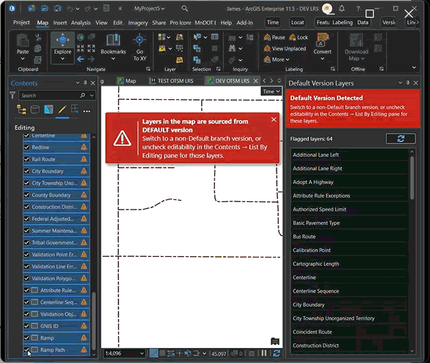

Optional feature - toggling editability
Features pointing to Default are only flagged if they are edit-enabled. Toggling editability off in the “List By Editing” Contents pane, will disable the alert system. This comes in handy when your map contains reference layers pointing to Default that you don’t intend to edit.
Toggling editability removes the alerts.Toggling editability removes the alerts.

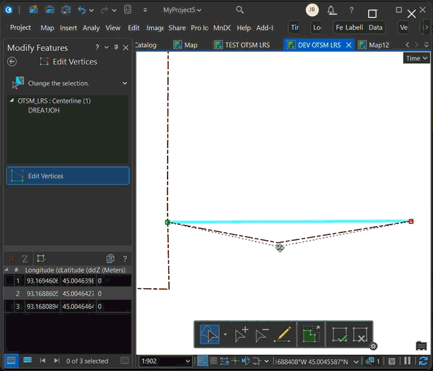

If the alerts are ignored or closed and the user attempts to edit data pointing to Default, a pop-up will fire to once again provide another warning. When edits are made to Default-sourced features, Default Version Guard will attempt to block the edit(s). See the table below for a summary of edit transaction types and blocking coverage:
Edit Interface
Edits blocked
Attribute Table
Yes
Attribute Pane
Yes
Geometry edits in map window
Yes
Calculate Field (attribute table)
Yes
ArcPy / Geoprocessing Tools / ModelBuilder
No
Location Referencing ribbon tools (merge events, etc.)
No
REST API
No
Edits in map window are blocked.Edits in map window are blocked.
