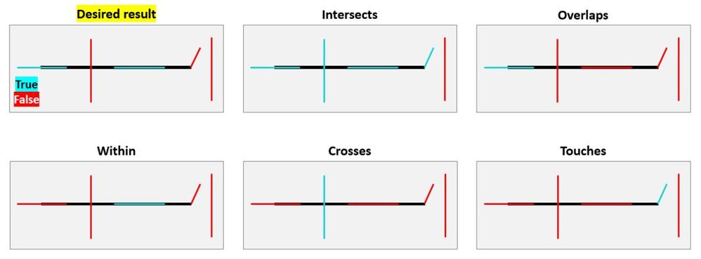

This diagram is from MnDOT's RHUG presentation also illustrates the true/false result for various "out-of-the-box" spatial relationships in Arcade:
We found that for most of our checks we needed a function that provided a combination of Overlaps, Within, and Contains (not pictured) and excluded cross-streets and adjacent lines that share a start or endpoint with our feature being evaluated. To accomplish this, we selected the "relate" function that allows us to define any spatial relationship we desire. This function utilizes the Dimensionally Extended 9-Intersection Model (DE-9IM) to define the spatial relationship. Here are a couple of links that dive into the details:
Custom spatial relationships—ArcGIS Pro | Documentation
26. Dimensionally Extended 9-Intersection Model — Introduction to PostGIS
And here's a snippet that gave us the "Desired result" shown in the diagram above:
for (var c in cartoActive) {
  if (relate($feature, c, '1********')) { // If true, return errorMessage
    return {"errorMessage": "Feature shares a line segment with cartoActive segment."}
