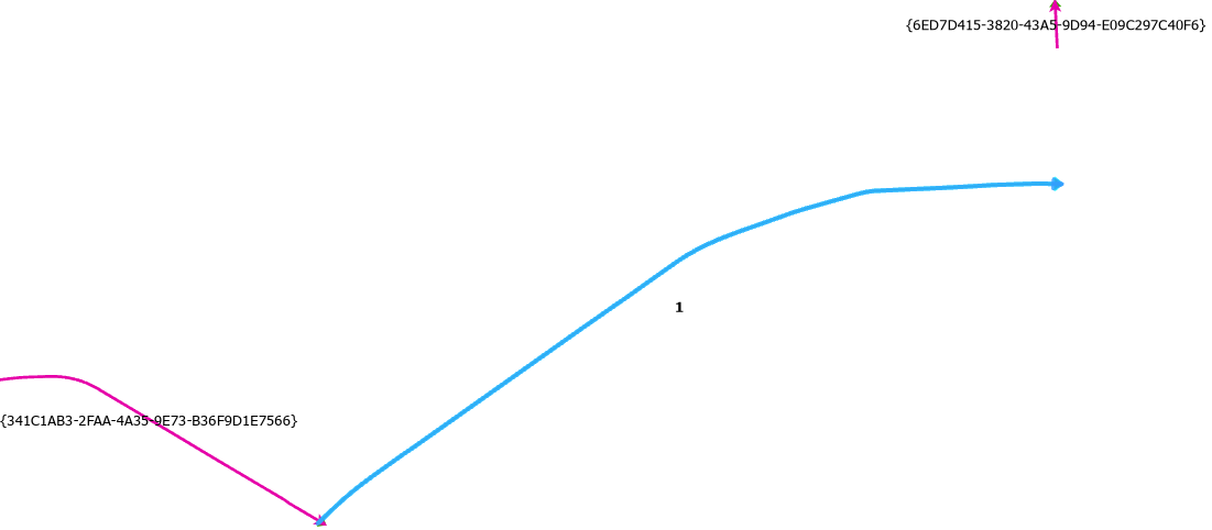

I am trying to create a new route on a line network between two existing routes as you can see in the screenshot below. The existing two routes (purple line in the image) are on the same line and the new one (blue) should be on the same line as well. However, Create Route tool does not like this and throw an error: "Cannot create a route at the start or end of a gap of an existing route in the same line". It seem to say it does not allow adding a route in the gap of an existing single route. Those two existing routes do not have any gaps. But there is a gap between those two routes. How can I accomplish what I need to do?

It's a byproduct of temporality. You cannot create a new route of an existing timeslice. Looks like you still intent to have a gap when all is said and done is that correct?
I don't like gaps as they do nothing but cause problems but yet they are valid to have. We try not to create and then not mess with if we have to. We use Euclidean Distance for our gap calibration. Your measure may act differently depending on the setting and how you model your lrs.
One method I did today on 10.8 that looks good measure wise to completely fill in the gap that I could quickly see was to reassign the blue route with a later date then purple and blue to the purple route. Selecting the first gap segment as my target route. The measures populated matched the first gap segment.
Personally I probably would have created a new route with the correct date along the gapped section to be filled and second gap segment. I would then have retired the second gap segment from the start of the gap section and then reassigned the new route to the existing route with the same from date.
The image has the top half with the method I first tried and the bottom half shows the second method. Hopefully this all makes sense.

Thank you all for the reply. All three routes need to have different attributes, so they need to stay as separate routes, but on the same line (a line in a line network) as they are all part of the same state route. We model each state route as a line in a line network. After everything is completed, there will still be a small gaps between the purple and blue (it is too small to see in the picture).
I tried some more and there was another gap earlier in the same line (state route), so I filled that with a new route, then it allowed me to create that blue route. But then when I tried to create another route after that blue route, it gave me the same error again. So I am wondering if I need to fill all the gaps??? Below is the picture of the gap I filled with a fake route. It happens where this state route stops at the overpass, then restart under the overpass. So physically there is a gap. So I created a small route to fill the gap with attribute indicating that the route is not real. On this particular state route, there are several of this type of gaps. We have another network that is derived from this line network, so we need to be very careful about adding fake routes, but if that is required then we can think of ways to do that.
