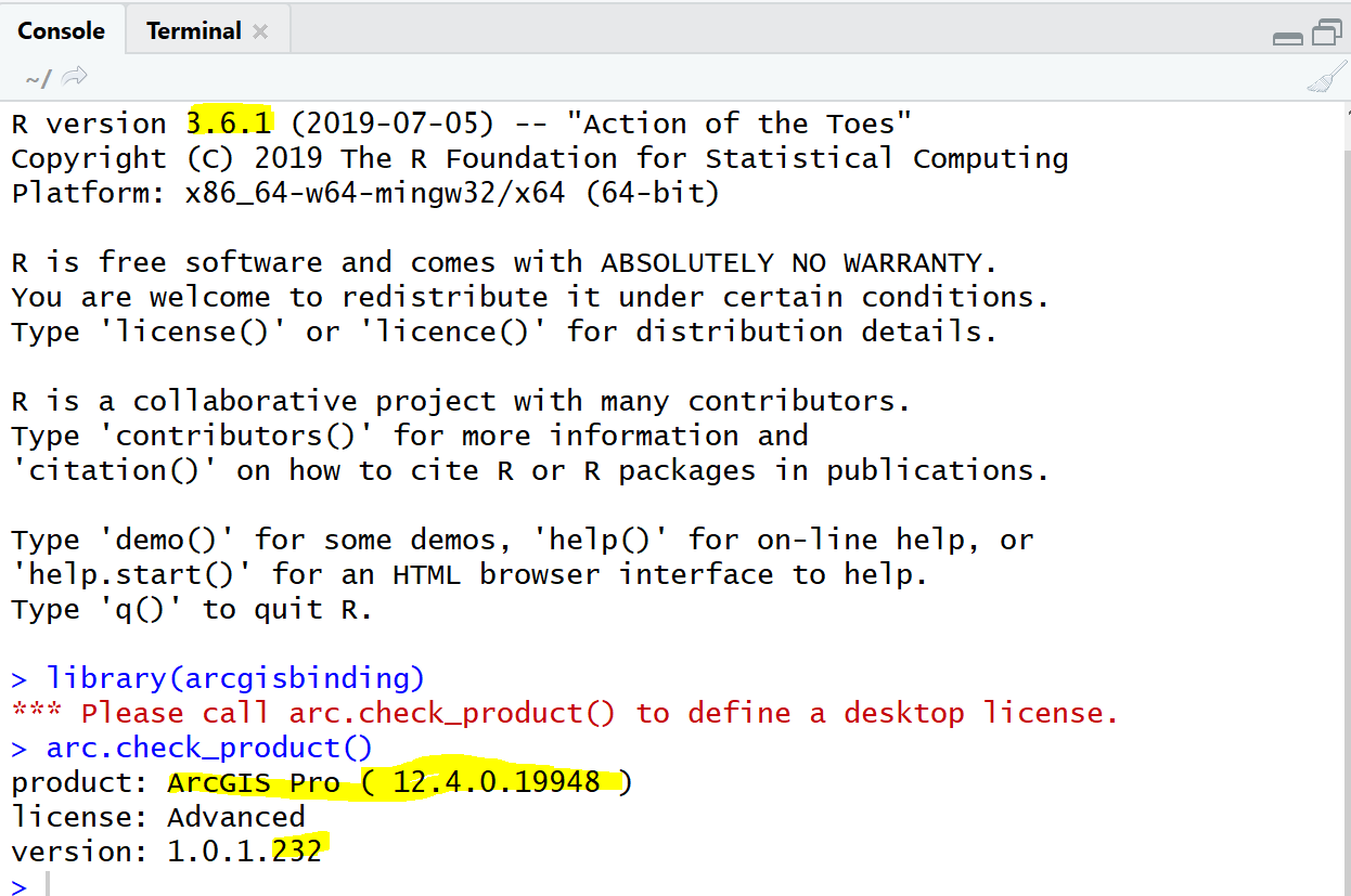

Thank you for checking Harley. I think I have an idea about the issue you are having. I installed your ArcGIS Pro, R and R-ArcGIS Bridge versions and able to get the bridge running (image below).
My Current R Studio Output

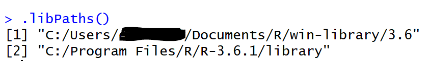

We did find some issues with using bridge with R-Studio and 3.6.1 however. It seems 3.6.1 points totwo directories. One in the install location (inside Program Files) and another in Documents (that is where you found arcgisbinding to be installed).  However, when R is updated sometime R-Studio does not add the second location where new packages are installed (one in Documents). Can you please run the following after you launch R-Studio with R 3.6.1?
.libPaths()
In my workspace, it returns the following
R-Bridge resides in the first directory. I suspect that R-Studio does not have the Documents/R in its libPaths. If you do not see the first path you can add that path by simply providing as an input to .libPaths.
If you do see it however, then bridge might not have properly setup it that case I suggest the following:
