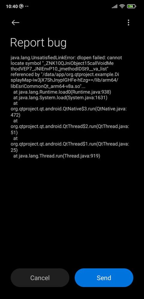

Hi,
I am learning to integrate QT with arcgis runtime api.
I have been able to display map on desktop, however after deploying it for android the application crashes.
Can anyone pls guide me on this?

E AndroidRuntime: FATAL EXCEPTION: qtMainLoopThread
E AndroidRuntime: Process: org.qtproject.example.DisplayMap, PID: 12572
E AndroidRuntime: java.lang.UnsatisfiedLinkError: dlopen failed: cannot locate symbol "_ZNK10QJniObject15callVoidMethodVEP7_JNIEnvP10_jmethodIDSt9__va_list" referenced by "/data/app/org.qtproject.example.DisplayMap-iw3jX7ShJnypIGHFe-hEzg==/lib/arm64/libEsriCommonQt_arm64-v8a.so"...

Hi @TasawarAhmad ,
 We are familiar with this problem.  Unfortunately with Qt 6.4, the ABI was broken so our Map SDK libraries (built with Qt 6.2.4) do not work.
You should be able to get it working if you use Qt 6.2.x, or 6.3.
It is fixed in Qt itself, but not until 6.4.3. More details here https://bugreports.qt.io/browse/QTBUG-109428

TasawarAhmad
Thank you. After downgrading to qt 6.2.4 everything seems to work.
