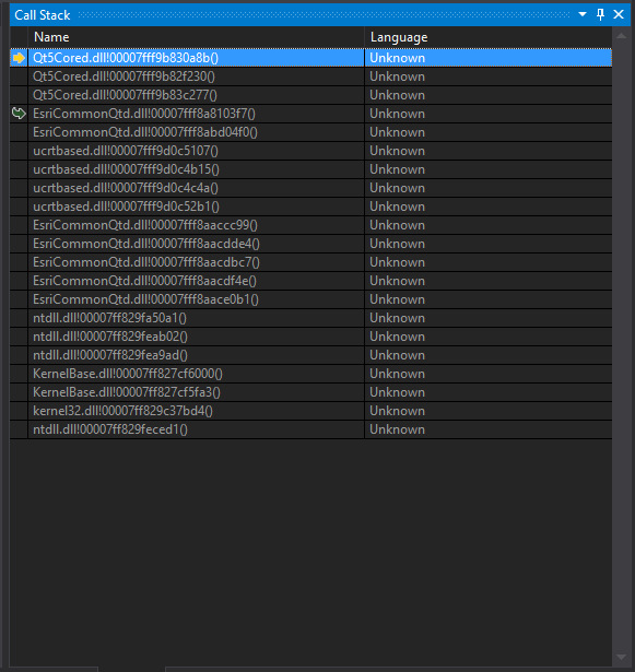

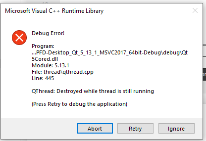

I'm just getting started with the ESRI Qt SDK and I've added a map window to my main.qml as an initial step in getting to know the SDK.  It works nicely during runtime but when I close the application a qthread exception is thrown and it's display for a few seconds and then it times out.  I've caught the exception in the debugger but I've got no symbols for where the exception originates. I have attached a screenshot of the call stack as well as the exception.
Seems like there must be some cleanup code somewhere that I need add to properly shut down.
