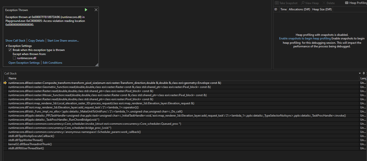

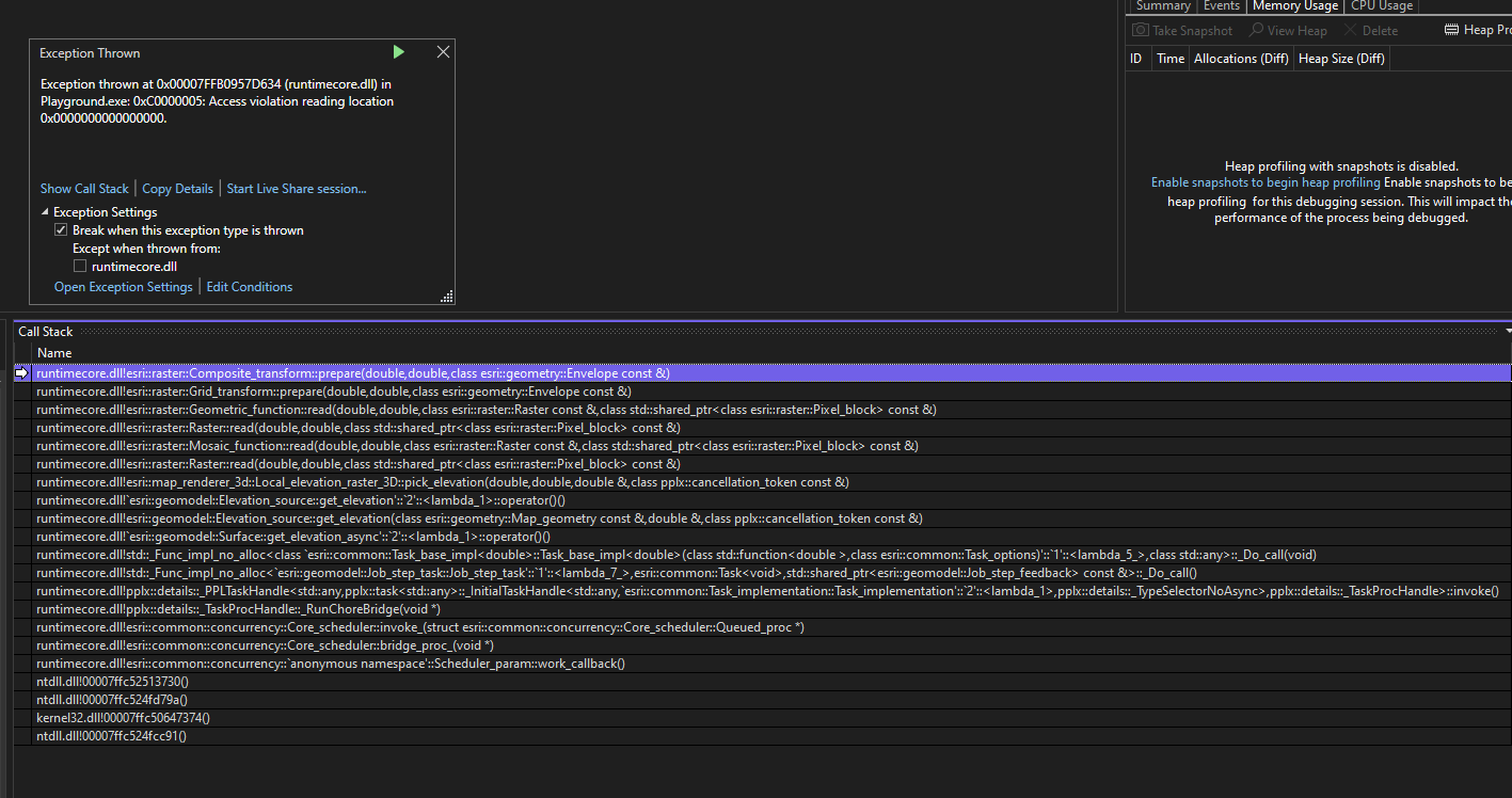

When the crash happens we get the following callstacks (sometimes they are slightly different)
