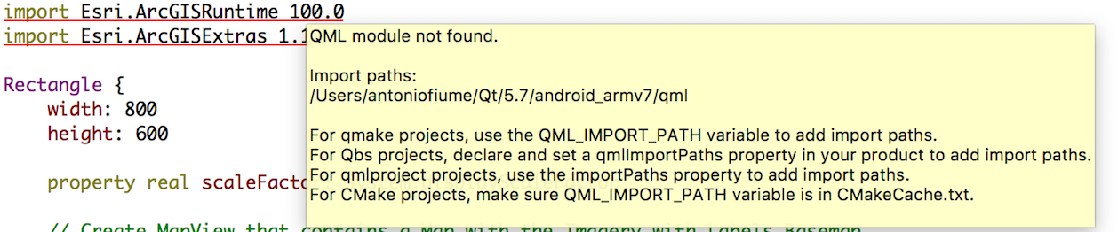

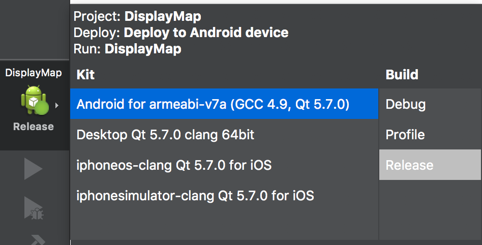

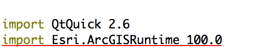

Dear All,
this problem is only when i selects the Android Deploy. In fact when i selects the Andorid deploy from QT Creator, the Map link in the editor appear in red underline. If i select Desktop deploy the underline disappear.
This is the massage:

LucasDanzinger
Esri Frequent Contributor
Glad you got it going. For future reference, try simply re-running the Post Installer instead of reinstalling the whole SDK. This utility copies the binaries and other files from the SDK installation into your Qt installation. The red squiggly lines indicate that the QML plugin wasn't present in the Qt installation, and so Qt Creator is complaining that it could not find it.
