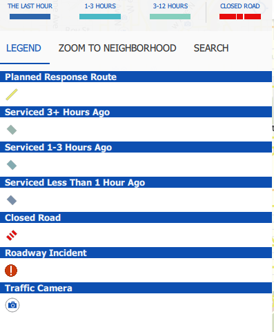

How do I retrieve the color of a simple line symbol from specific layers in a web map?
I'm using an existing web map and want to create my own symbols for 3 of the layers in the map. I am able to create the full legend via the sample but I'm struggling to simply grab colors. In the image below, the full legend created from the LegendInfoListModel is at the bottom in the tab but I need to color the rectangles at the top according to the legend info (hard coded now). I am a web developer so perhaps am missing a pattern here. Any help?

DavidPuckett
Thanks for this Nick, I should have provided more detail however. I am having 2 issues that are keeping me from applying colors dynamically:
  1. The legendInfo.name property returns an empty string for every legendInfo item so I am not able to find specific legend items to grab the color from
  2. I cannot capture the map.legendInfos because the onFetchLegendInfosStatusChanged signal returns an error (when placed within the Map item).
For now I am using the operationalLayers to get the color for specific layers via the renderer like so:
operationalLayers.forEach(layer =>
        // only way i can see to identify layers is by name, brittle but...
        if(layer.name === "Serviced 3+ Hours Ago") {
          servicedRoute3PlusHoursLayerLegendColor = layer.renderer.symbol.color;
        else if(layer.name === "Serviced 1-3 Hours Ago") {
          servicedRoute1To3HoursLayerLegendColor = layer.renderer.symbol.color;
        else if(layer.name === "Serviced Less Than 1 Hour Ago") {
          servicedRoute1HourLayerLegendColor = layer.renderer.symbol.color;
        else if(layer.name === "Closed Road") {
          closedRoadLayerLegendColor = layer.renderer.symbol.color;
I am certainly open to using legendInfos if these issues can be resolved and share with the community here.

DavidPuckett
Right, this is interesting. First, it appears that the 'name' property in legendInfo is the 'label' in the legend item. And, if there is only a single symbol for the layer, the name is not included in the legendInfo item. This is a good explanation of what's going on albeit a little confusing to navigate. So really what I was after was the layerName and that isn't found within legendInfos. Now if I were using unique symbols for example it would be useful.
So ultimately, for my situation, getting the symbol colors directly from the layer renderers was the solution.
This latest example provided the clarity to get there and hopefully others with issues around legendInfos will find it useful.
