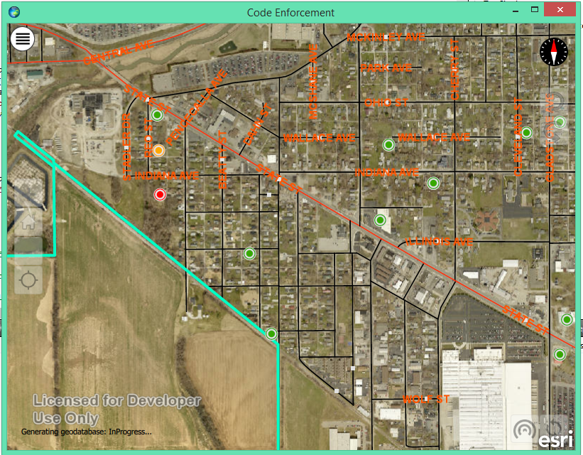

I am getting this error whenever I load a FeatureLayer using a GeodatabaseFeatureServiceTable . There is one exception per feature in the FeatureLayer and it only happens once per load . So I have 77 features in the featureservice I am loading the following exception happens 77 times when the application first loads. It does not happen again.
Exception at 0x7ff810fe8b9c, code: 0xe06d7363: C++ exception, flags=0x1 (execution cannot be continued) (first chance) in EsriRuntimeQtd!EsriRuntimeQt::FileGPSLayer::qt_static_metacall
Is this something I should be concerned about ?
Cheers
Prem
5 Replies
PremRadhakrishnan
After upgrading to 10.2.6 this has changed to and now it happens not just the first time but every time the map changes and I do not see a correlation of the number of errors and number of features
D3D11 ERROR: ID3D11DeviceContext::RSSetScissorRects: ScissorRect at slot 0 is invalid. Valid Rects have left (value = 0) <= right (value = -4) and top (value = 446) <= bottom (value = 527). [ STATE_SETTING ERROR #260: DEVICE_RSSETSCISSORRECTS_INVALIDSCISSOR]
This is not affecting anything that I am doing yet, but I am not sure if that will remain true as I add more functionality to the application. As you can see the layer is pretty simple its a point layer with a unique value renderer . If I turn the layer off then the errors stop so I am sure that it is related to this particular layer which is loaded from a secure Feature Service.
