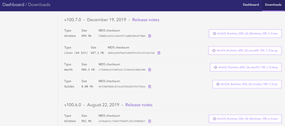

JaredCaccamo
@johnmarker
Just for reference, the minimum required Qt framework for 100.7 is 5.12.6 which can be found here.
