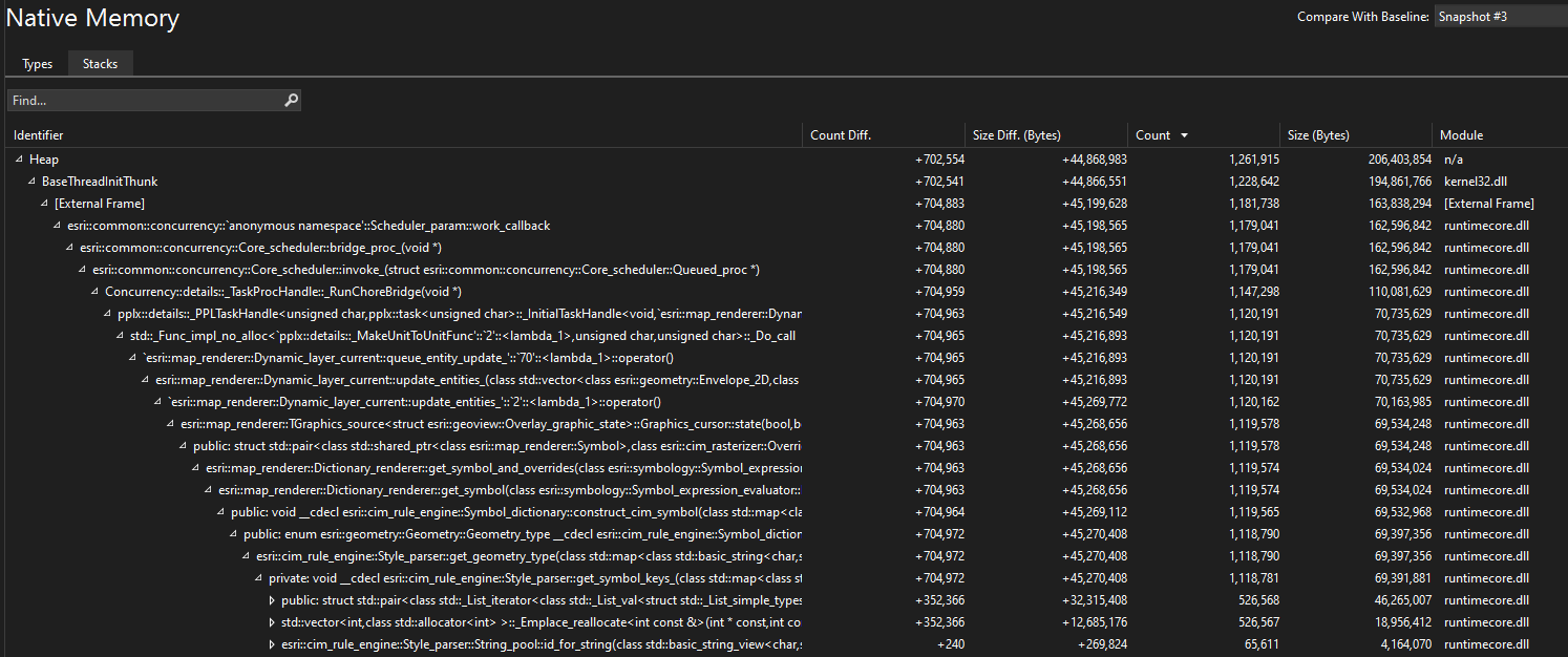

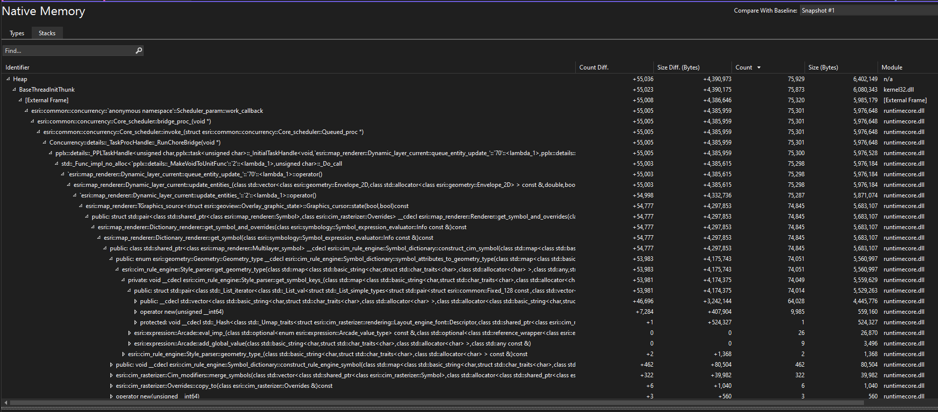

However, with both of these version we still experience the same issue.

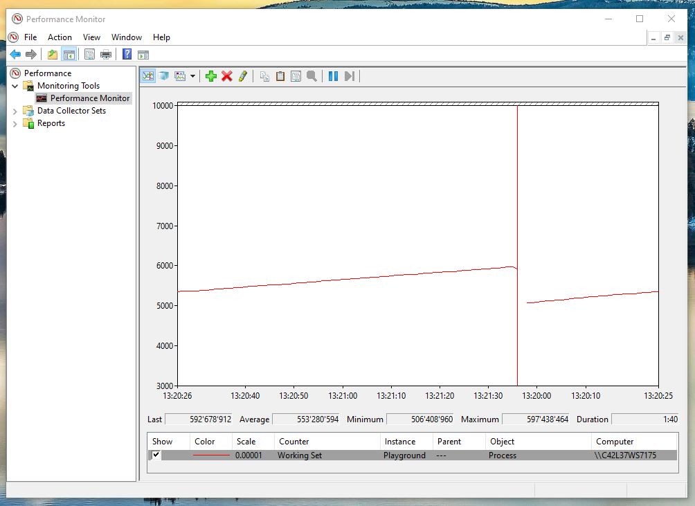

Working set of the process is steadily increasing:
Allocations do not seem to get deleted from the function `esri::cim_rule_engine::Style_parser::get_symbol_keys`
ArcGIS SDK v200.8.2
ArcGIS SDK v300.0.0
Is a cache of symbols being built? How large can we expect this cache to grow?

imbachb
I ran some tests over the weekend: It seems that memory consumption is relatively stable after a while. Could someone from ESRI confirm that memory consumption for symbols grows only to a certain level and then remains stable? For our use case this is very important as our applications tend to run for days without restart. Many thanks!
