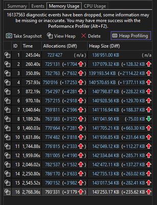

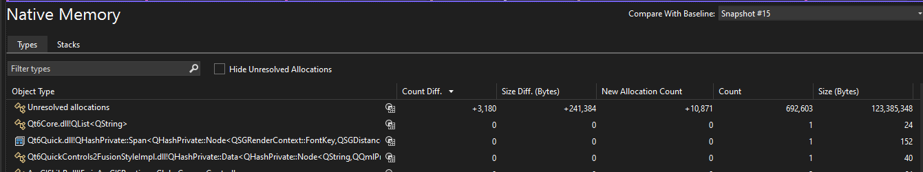

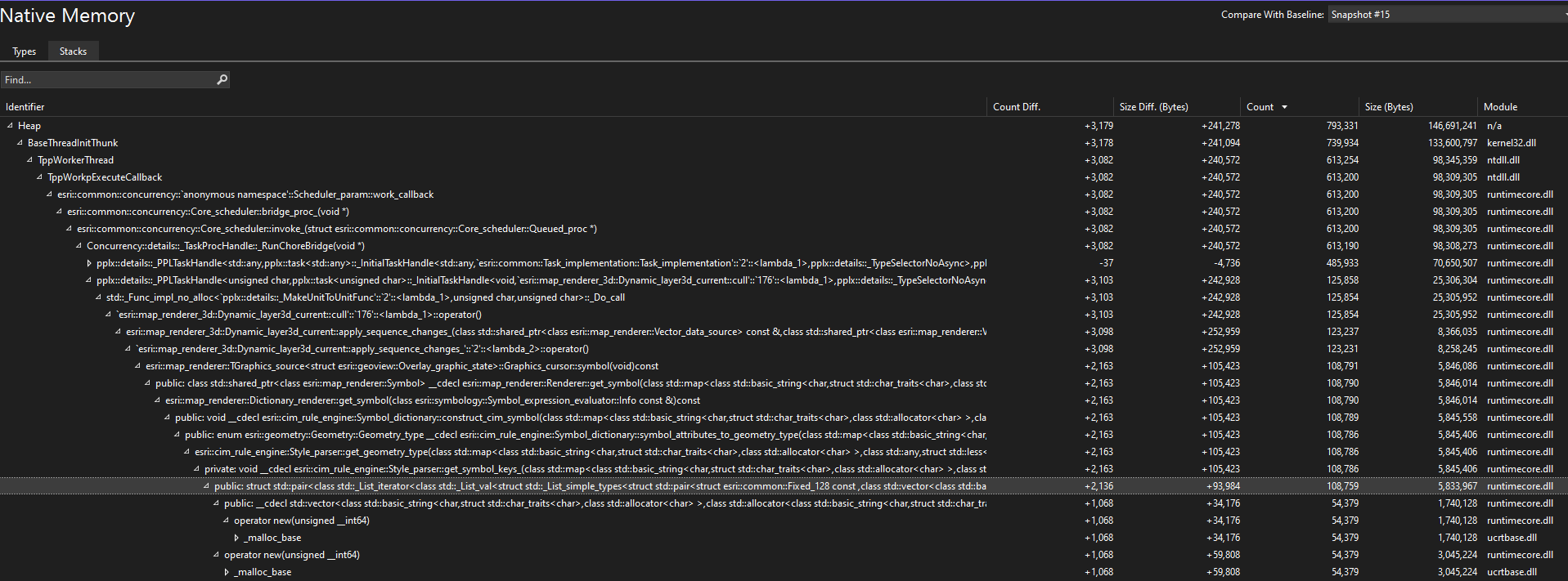

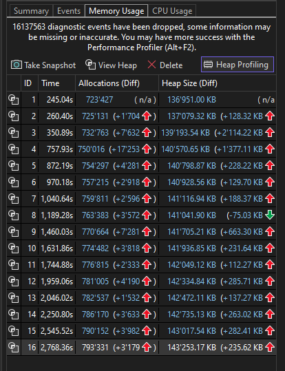

We also did some heap snapshots to see if we can identify the issue:
As you can see in the stacks, code regarding the symbols was the cause of most new allocations.
