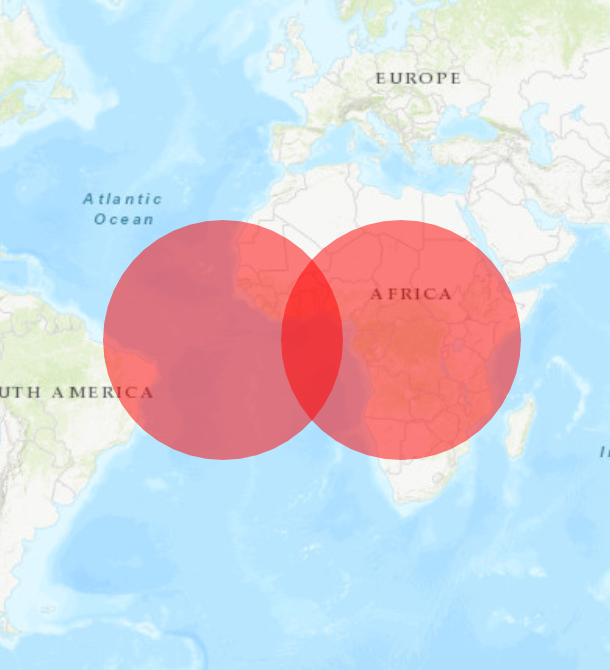

Yes. Instead of applying opacity on the GraphicsOverlay, apply an alpha value to the color of your symbol. For example, the below code gives me this result:
// add a mapView component
MapView {
    anchors.fill: parent
    // set focus to enable keyboard navigation
    focus: true
    // add a map to the mapview
    Map {
        // add the BasemapTopographic basemap to the map
        BasemapTopographic {}
    GraphicsOverlay {
        Graphic {
            Point {
                x: -20
                y: 0
                spatialReference: SpatialReference {wkid: 4326}
            SimpleMarkerSymbol {
                color: Qt.rgba(1,0,0,0.5) // this is the key part - set alpha value when defining color
        Graphic {
            Point {
                x: 20
                y: 0
            SimpleMarkerSymbol{
