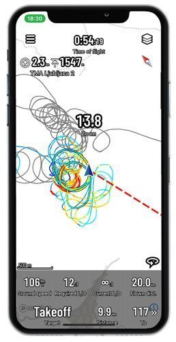

I would like to draw the user's track on the map, and use a color scale to represent a third axis of data. For instance, in the below, this is a breadcrumb track where the color could represent speed along the ground.
Others have asked about something similar, but so far there's no canonical documentation that I have found for multi-color polylines or polygons. I have looked through the SDK documentation and it seems that since LineSymbol is only inherited by SimpleLineSymbol this multi-color geometry might be currently unsupported.
I suspect that this might be doable by using a ListModel of some sort, e.g. GraphicListModel or GraphicsOverlayListModel, but I worry about the impact on system resources. (Typically, a large array of data structures is orders of magnitude less performant than a single structure containing a large data array.)
