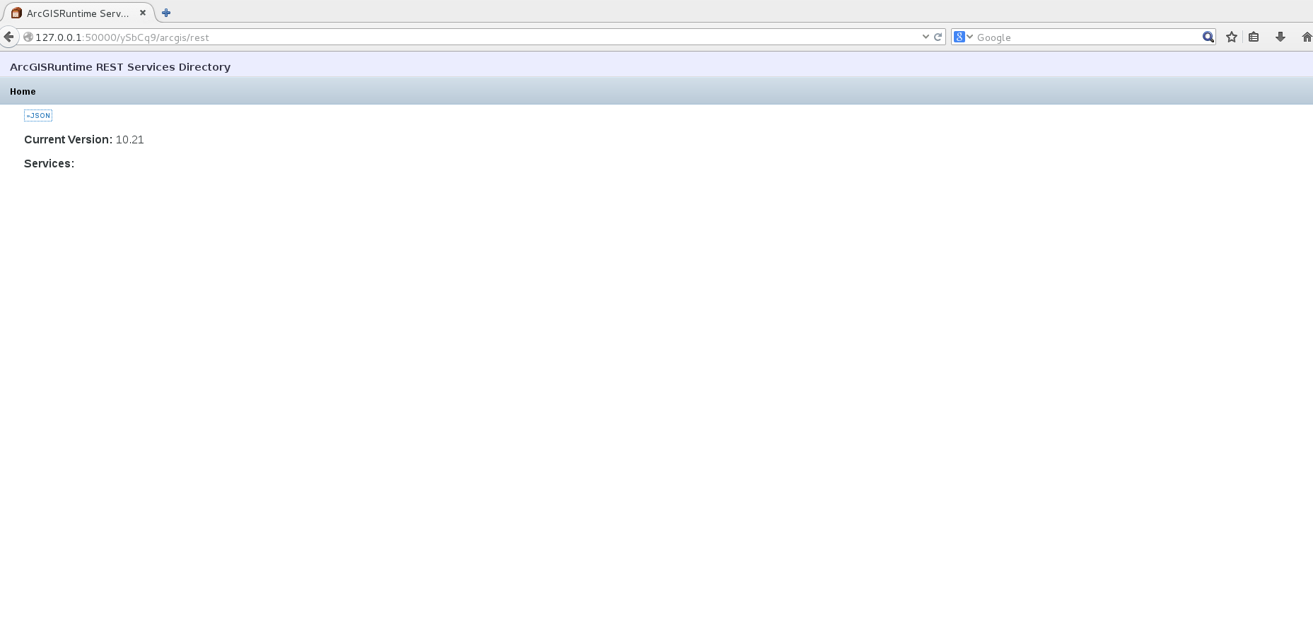

what is the problem for you?

Is the path to the MPK correct? It seems like it starts up the local server itself, but the service is not starting.

Hello Lucas,
Yes, the path is correct and the same example works in the red hat 6.6, I
tried to control of the RESTservice page, and I get this:
"crashed" : false,
"createParams" : {
"filePath" :
"/home/valerio/arcgis/runtime_sdk/qt10.2.6/sdk/samples/data/mpks/USCitiesStates.mpk",
"maxRecords" : "1000",
"name" : "USCitiesStates.mpk",
"outputDir" : "Z:/tmp/arcgisruntime_8/USCitiesStates.mpk",
"type" : "MapServer",
"virtualDir" : "
http://127.0.0.1:50000/bvRtc0/outputdir/USCitiesStates.mpk"
"endpoints" : [
"processId" : -1,
"socs" : [
"createParams" : {
"filePath" :
"virtualDir" : "
"description" : "REST handler",
"errorReports" : [
"id" : "host",
"pid" : 46,
"status" : "Starting"
"starting" : true,
the service remains in the "starting" status.

I missed this in the original title of the post, but The issue is likely the version of red hat you are using. With our 10.2.x release, we support 6.2-6.6. Please see the system requirements here - System requirements—ArcGIS Runtime SDK for Qt | ArcGIS for Developers
Red hat 7 has been known to work with our API in general, but not with local server, due to wine compatibility issues. We are planning on targeting red hat 7 for our Quartz release, which comes out later this year.
