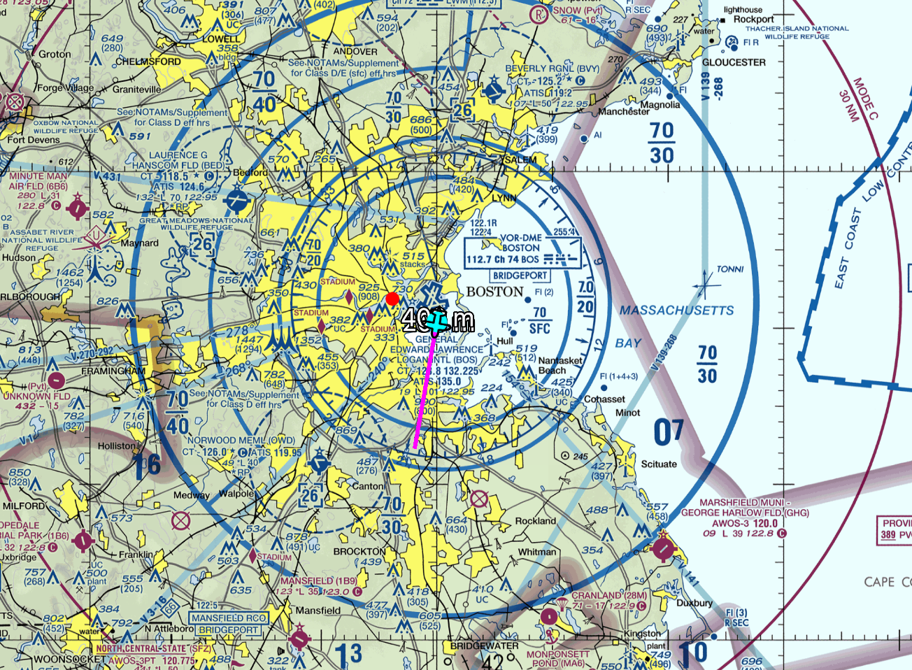

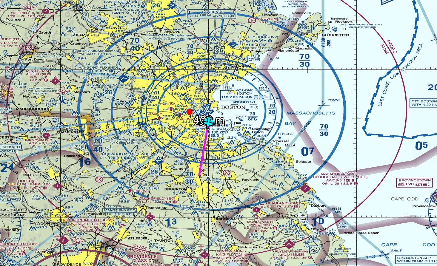

For whatever reason, with most basemaps the imagery from the attached KML file is vertically-- but not horizontally-- squished.
ArcGIS.Enums.BasemapTopographicVector
However, at least with `BasemapStyleArcGISImageryStandard` it works.

Using some debug statements to look at the spatial references, I'm not seeing a difference between the two basemaps. AFAICT so far, the KML should be projected the same in both cases but very visibly is not.

LucasDanzinger
Esri Frequent Contributor
This is invalid and should be
Enums.BasemapStyleArcGISTopographic
What is happening is the basemap style enum was invalid so the basemap fails to load, so the map takes on the first layer's spatial reference, which is the KML in WGS84. The basemap styles are all in web mercator, so we are comparing two different spatial references, hence the different shape.

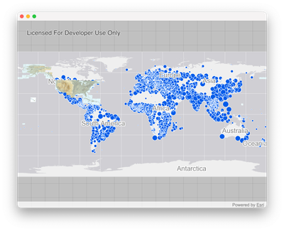

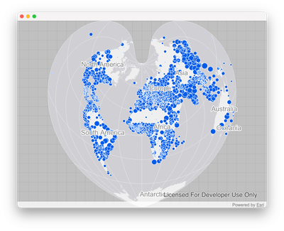

KennSebesta
Using the SetMapSpatialReference sample app, and adding the KML layer, it looks like it clobbers the map's spatial reference.

Without KMLLayer:
With KMLLayer:
