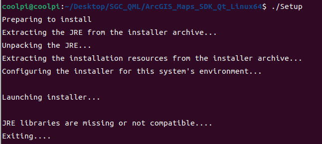

The ArcGIS for Qt package was downloaded. When I run the setup file, it reminds me that JRE libraries are missing or not compatible, as shown in the following screenshot. I have already installed the openjdk-11-jdk package. It seems something wrong with the Java environment but I need more detail about the specific missing parts. Waiting for help...

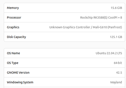

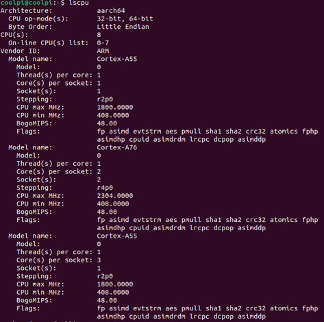

Thanks for your reply! Here are some details about my platform.
JamesBallard1
@GuochaShui thank you for sharing the details. I see you are running an Arm-based CPU and Linux distro. Unfortunately we only support x86 family of CPUs for Linux desktop at this time. We are always interested to hear from our users about new use-cases for our product.
Also it seems you are targeting an embedded Linux device. If there is any specific use-case you're trying to support, we'd love to hear about it. You can post here, or send me a DM if you prefer.
