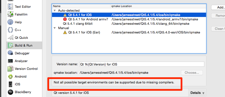

I was building a new deployment for an iPad and through the Apple developer site it requested I accept a new license agreement today. When I downloaded a new provisioning profile it updated Xcode and now the build kits for iOS are invalid in QT Creator.

We contacted Qt support to know for sure what is and is not supported. It looks like with the current release of Qt (5.5), Xcode 7 is not supported. Here is the info they provided us:
You can find the list of supported platforms and compilers from this link: http://doc.qt.io/QtSupportedPlatforms/index.html
iOS 8.1 - OS X 10.9 host clang-600.0.54 CI Tested
clang-600.0.54 is Xcode version 6.1.
XCode 7 is not in our CI build pool and thus it's not supported.

Problem is not with building on the mac it is iOS. The iOS kits are now invalid due to some library files missing and not sure why.

We are looking into the problems with Qt on iOS with Xcode 7. We will post more information here when we have it to share. In the meantime, consider rolling back to Xcode 6. Thank you.
