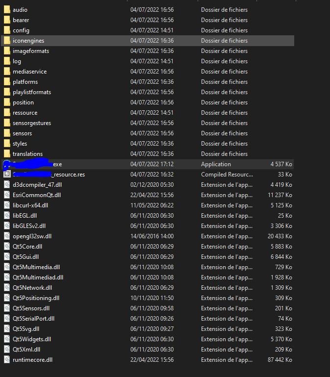

Hello,
I have a problem, whene i would like deploye my application, the map was not here, i have juste a big white page with the notion "ESRI". I use windeployqt for have any dependences but, i suppose is not sufficient. I share my folde with the different files for my application.
if you have any solution or any possible reseach, say me.
Thanks !
MichaelMatano
Hello Vincent, from your list of dependencies I cannot see OpenSSL libraries. Do you have the libraries installed and added to the PATH? The easiest solution is to copy the .dlls libcrypto and libssl into the .exe directory that you are trying to deploy.
MichaelMatano
VincentB38
it was this, it work ! thank's for your help.
