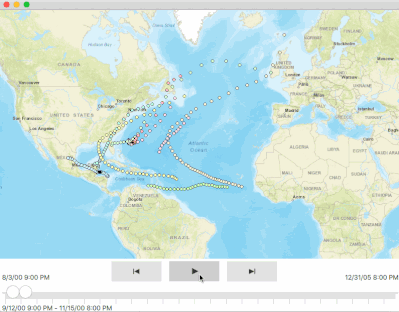

I currently try to implement the TimeSlider Widget with QtQuick. For a better understanding of this TimeAware things i want to know if there is any example for the TimeSlider from Toolkit. I look for something like the first animation/gif here:

You can get TimeSlider up and running by doing the following:
- Create a new Qt Quick C++ project from our template
- include the toolkit PRI in your pro file -
include(/path/to/arcgis-runtime-qt-toolkit/uitools/toolkitcpp.pri)
-  register your components in the main.cpp -
#include <Esri/ArcGISRuntime/Toolkit/register.h>
Esri::ArcGISRuntime::Toolkit::registerComponents(engine);
- Add a timeslider to your qml:
    MapView {
        anchors.fill: parent
        // set focus to enable keyboard navigation
        focus: true
        TimeSlider {
            anchors {
                left: parent.left
                right: parent.right
                bottom: parent.bottom
            geoView: view
- Add a time enabled layer, such as this map image layer
ToolkitTestCppQuick::ToolkitTestCppQuick(QObject* parent /* = nullptr */):
    QObject(parent),
    m_map(new Map(Basemap::streets(this), this))
    auto imgLyr = new ArcGISMapImageLayer(QUrl("https://sampleserver6.arcgisonline.com/arcgis/rest/services/Hurricanes/MapServer"), this);
    m_map->operationalLayers()->append(imgLyr);
- The time slider will automatically get the time extent, and you can manipulate/filter the time:
