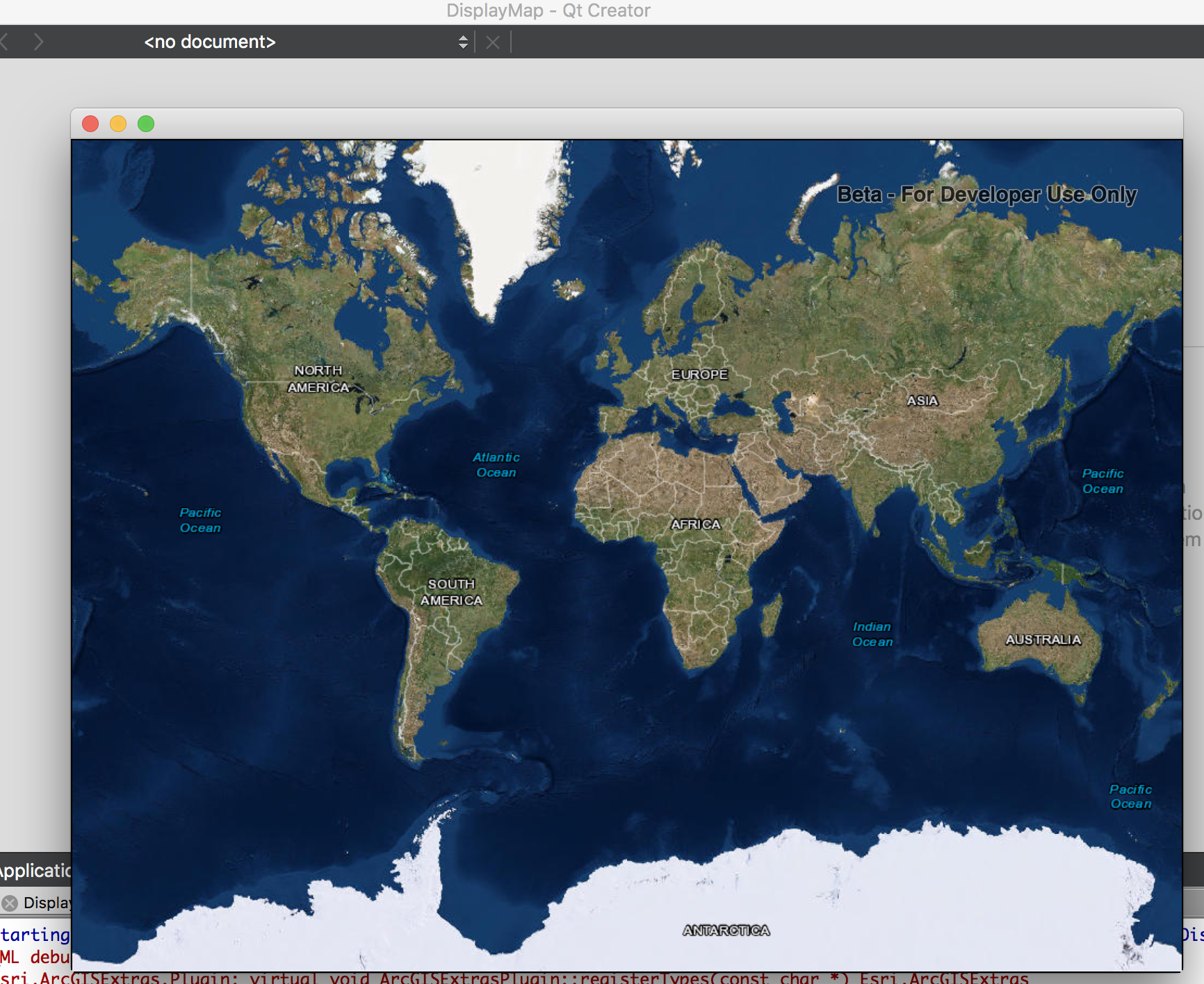

I created a simple ArcGIS QT Application that show a simple world map with QT Creator.
When i run the Application with QT Creator and Window Kit the app works fine.

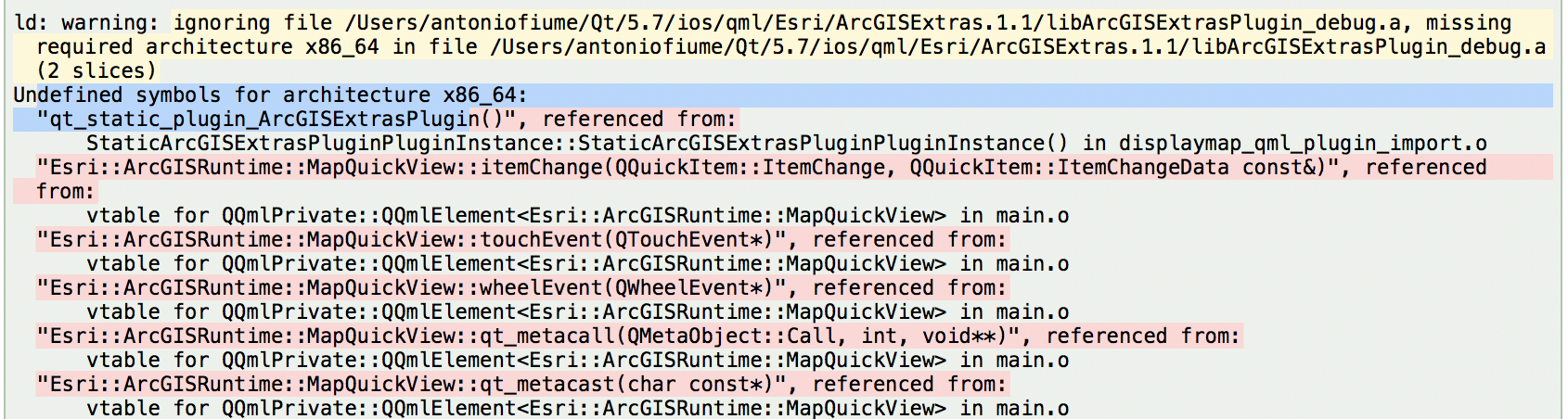

Then, I converted the application to run with xCode to deploy the app to my iPhone.

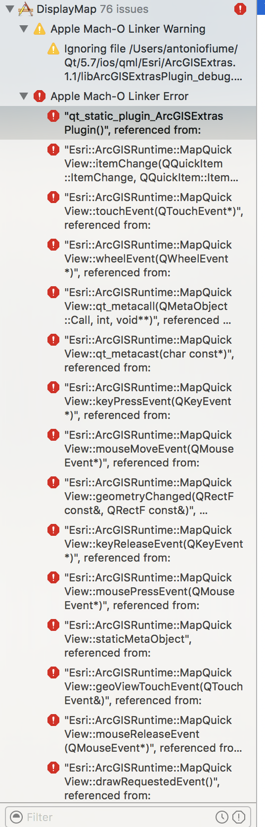

When i run the xCode project the system shows 70 errors.
There are particular procedure to export the Qt Application to xCode or i missing something?

If i create a new project with QT Creator and create a new GIS application works fine.
If i create a simple application and then inserts the import in my file, in desktop works fine, but when export in xcode have the same errors.
I missing something reference in qt project? I added only arcgis_runtime_qml100_0_0 in CONFIG in .pro file
