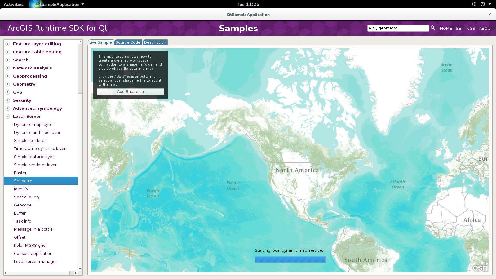

Currently we are working in ArcGIS Runtime SDK for qt verison 100.1 on OpenSuse with developer licence . We are exploring sample applicaions based on local server for displaying shapefiles. But the application is not displaying the shapefiles.The applic

We have a sample in our v.next branch of our sample repo - arcgis-runtime-samples-qt/ArcGISRuntimeSDKQt_CppSamples/LocalServer/DynamicWorkspaceShapefile at v.n...
It is technically for 100.2, but it will work with 100.1 as well. If you clone the repo and checkout the v.next branch, the only thing you will need to change to get it to work with 100.1 is to go into the .pro file and change ARCGIS_RUNTIME_VERSION from 100.2 to 100.1.

On running the  sample v.next Dynamic Workspace ( Linux )  , i am able to select the shapefiles , but its is still not rendering. .The  the localServer   logs shows  "datadir doesnot exist"  and  creates one , Please find the logs .
Also on an equal note is there anyway we could render locally stored  shapefiles without  instantiating LocalServer ?

Did you make sure to setup the mpk_blank.mpk as described here - arcgis-runtime-samples-qt/ArcGISRuntimeSDKQt_CppSamples/LocalServer/DynamicWorkspaceShapefile at v.n...
Basically, download that mpk and place it at C:\users\vishnu\ArcGIS\Runtime\Data\mpk\mpk_blank.mpk
As for rendering without local server, this will be possible in the next release of ArcGIS Runtime, which is due out near the end of this year.
