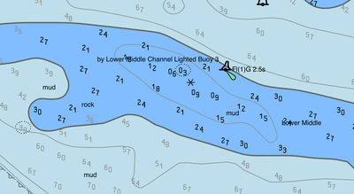

The following images are taken from a viewpoint in the Boston harbor area, at 42.34, -70.99.

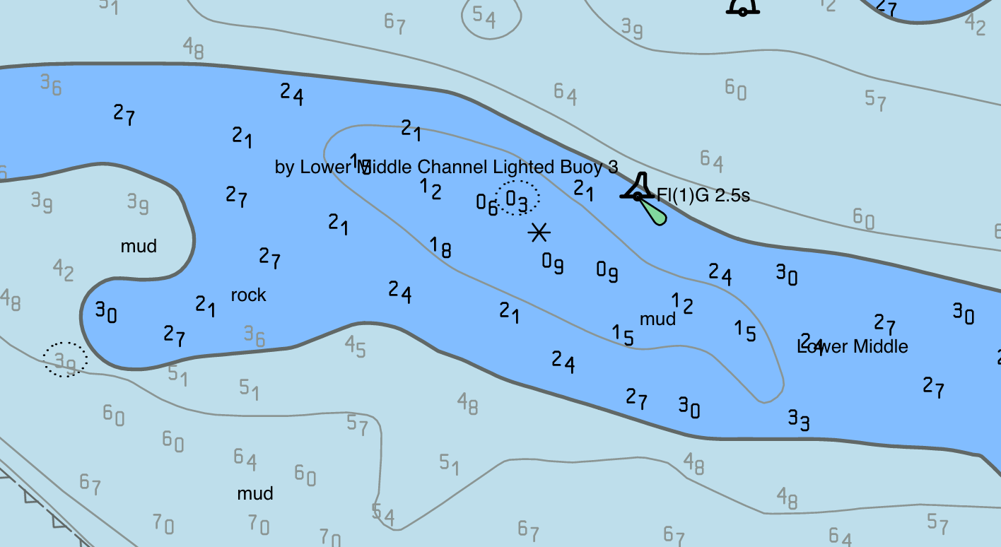

The first image is from a custom QML app:

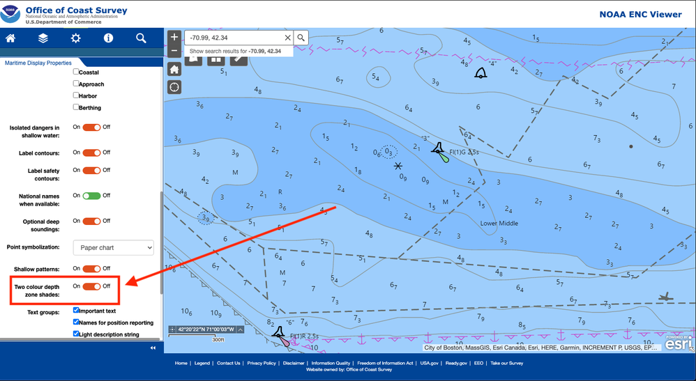

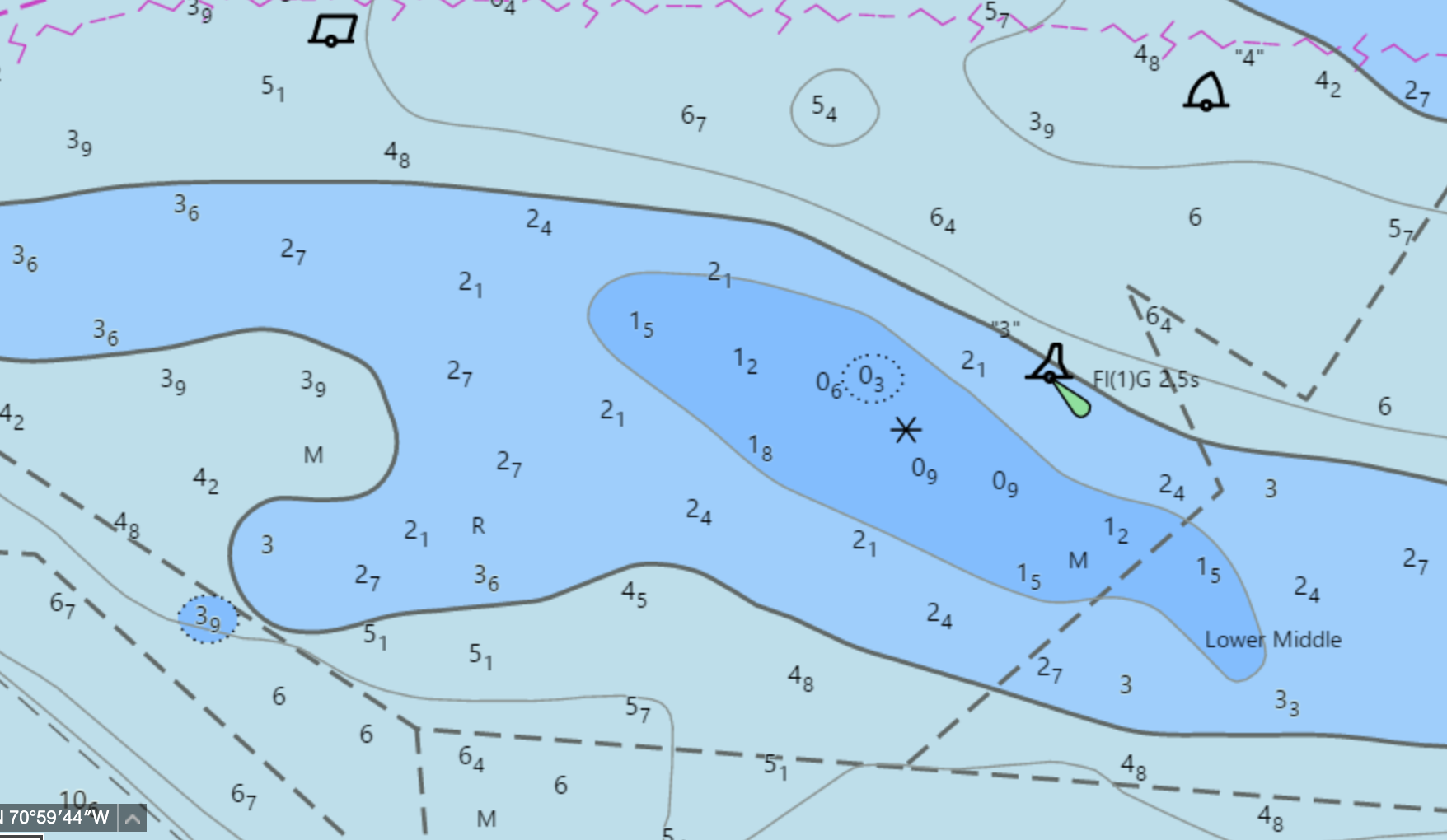

The second image is from NOAA ENCOnline.
In the second image, the area between Safe and Shallow is colored differently from the area inside the Shallow contour.

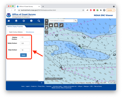

I cannot reproduce what you're seeing at https://www.nauticalcharts.noaa.gov/ENCOnline/enconline.html. Can you confirm if some other Maritime display properties are needed to display the four-color mode? Here's what I did (see screenshot from online viewer). At that long/lat the section in question displays identical to your Runtime screenshot.

KennSebesta
@JamesBallard1 thanks for the rapid response. I think the difference we're seeing is that NOAA ENCOnline sets different default depths. Here's what I'm using:
These are the same depths I have in my settings for my Qt app.

@KennSebesta thanks for the info. I see what you're seeing in the online viewer now. I don't have the offline dataset for that region near Boston to display and troubleshoot with Runtime, but I do see that this is working as intended with the sample dataset.

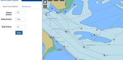

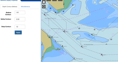

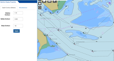

Bit of an update. By grabbing the NOAA ENC for Boston Inner Harbor (https://charts.noaa.gov/ENCs/Agreement.shtml?US5MA11M), I can reproduce this with the AddEncExchangeSet example.
*Currently*, I cause the failure by toggling between `shallowDepth = 1.8` and `shallowDepth = 1.81`.
Curious, I went back to the NOAA ENCOnline viewer. It turns out that this display issue is reproducible in their online viewer as well. What's strange is that it's highly dependent on the exact values.
I'm not a big believer in coincidences. 1.80m = 5.906ft, 1.801m = 5.909ft, so there's no magic threshold being crossed in another unit system.

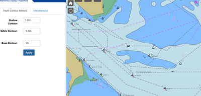

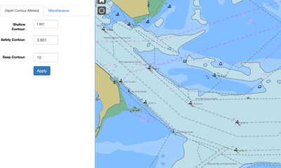

Playing around, I realized that 1.81 becomes valid once the safe depth goes above 3.6.
This might be a NOAA or S-57 thing, where 0.30m is approximately 1ft (although 1.8m is 5'10 3/4", not 6ft!), and all data is being forced into the closest foot bucket. That would be wrong, but considering the imprecision there might be nothing which can be done about it.
Likewise, with the ENC provided sample dataset, it looks like the settings have a similar effect, but for a different range of values. I'm beginning to think that what I'm seeing is an interaction with some underlying feature of the dataset which is subtle but relevant. (I'm learning here, so apologies for not understanding the full extents of the ENC's backend.)
