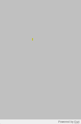

My customers with poor internet connectivity are reporting a blank map screen.

If you start with the template "ArcGIS Maps 200.7.0 Qt Quick C++ app" and do not make any changes other than adding an API key, then the map will fail (just gray screen) when there are network issues as described in the original post.
The problem is that the failure is not graceful as no overlays or anything else shows up - the map is just in a bad state.

The "loadStatusChanged event not firing" may not be a bug - since there is nothing being loaded. It is odd that I get it when using "new Map(this)" and manually adding a basemap though. It looks like it is emitted when there is a change to the map's spatial reference.
It could be that the map is trying to figure out what its spatial reference should be as part of initialization. The gray screen is a symptom of that process failing. For example, normally loading a web tiled layer initializes the spatial reference as a side-effect, but if that fails (due to network connectivity), then we end up in a bad state.
