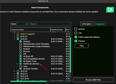

First, our Maps SDK for Qt requires the positioning, sensors, and websockets Qt modules. Double check that those are present when you installed Qt. Those are typically listed as additional liraries

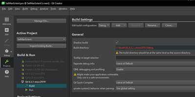

As for the strange "no such file" problem, that could be a Windows-specific problem we run into on the team ourselves. That (any related problems) happen with very long paths. One way that we deal with that is to drastically shorten the shadow build folder path. Here's an example on my machine. In the projects tab, I changed the "Build directory" to a shorter length than the default.

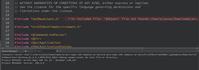

But all of the project files give a message that they are not included in the project, and now the QObject header cannot be found:
JamesBallard1
Ok, it sounds like you're on the right track now. I do see something in your screenshots worth pointing out. You are using the Windows MinGW Qt kit, which we don't support. We only support the MSVC 2019 kit on Windows.

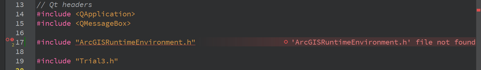

I changed to MSVC 2019. Thanks for pointing that out, but the same problem happens:
Also It says that the files are not included in the project even though they are written in the .pro file

I did it but it did not fix the issue. Here is a screenshot for the build issue
And here is a message that came:
JamesBallard1
Ok based on those messages, there could be two different issues.
