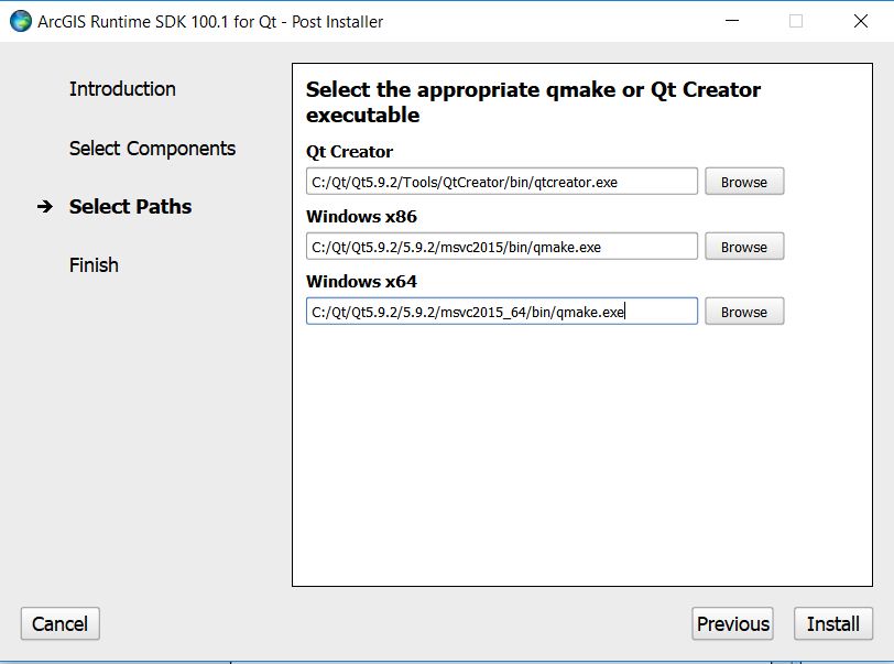

I am trying to include the ArcGIS Qt SDK in my Qt App to load maps. I have the latest community edition (4.4.1) and the latest Qt Version (5.9.2).
In the postinstaller, I put this in:
Screenshot of my postinstaller

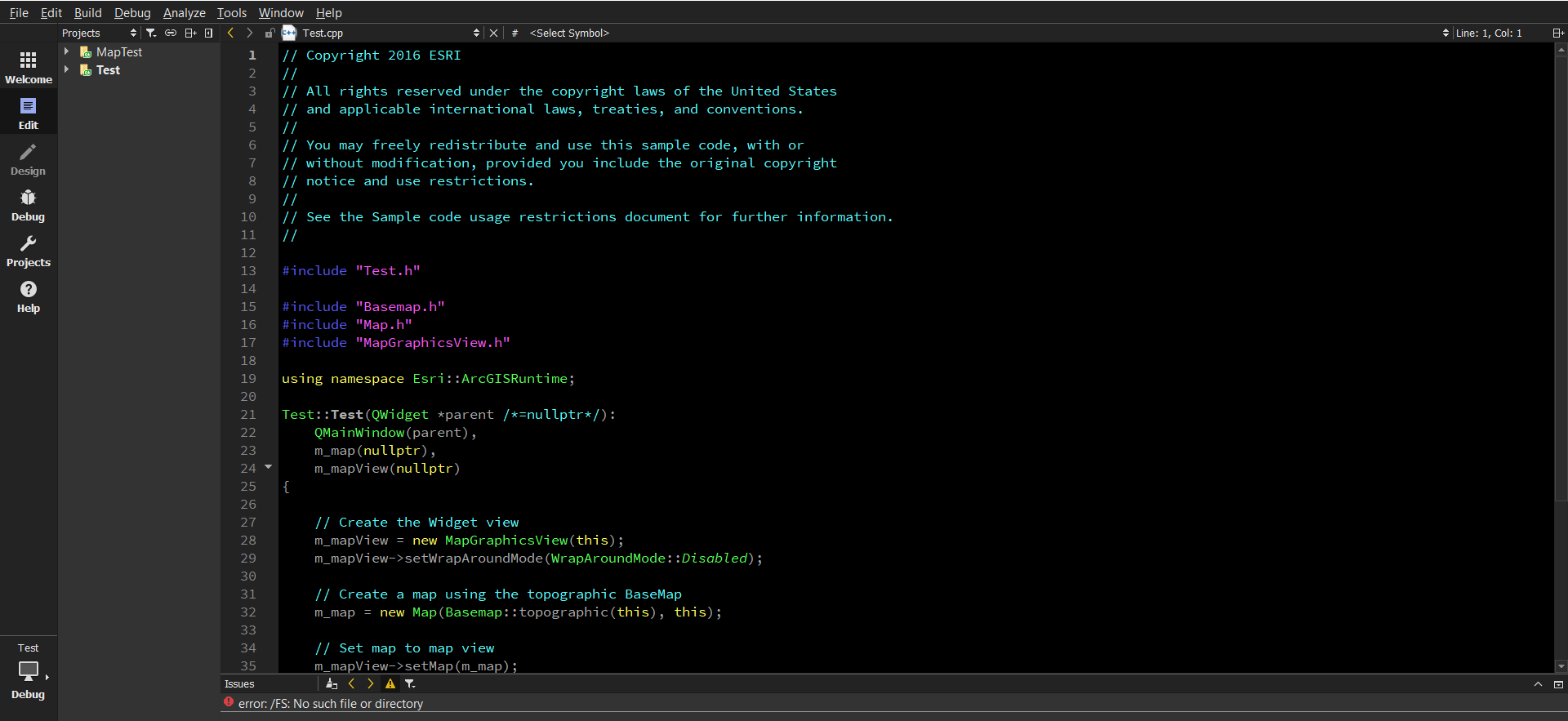

But unfortunately when I create a basic app in Qt (New ArcGIS Runtime 100.1 Qt Widgets App), and I don't even change the code, I get this error in QtCreator, which reads :
error :/FS: No such file or directory
My QtCreator error
What am I doing wrong? This error gives me no indication on what I have done wrong, and can't seem to pinpoint the origin of the problem. I reinstalled Qt several times as well as the ArcGIS SDK, but still no luck. The error also occurs on a QML application...
Any ideas? Has anyone had this problem and solved this? Thank you!
LucasDanzinger
Esri Frequent Contributor
Are you able to build and run a non-ArcGIS project in Qt Creator with the same kits selected? I am wondering if maybe the Microsoft Visual C++ compiler is not set up correctly, or if Qt Creator cannot find it for some reason?
