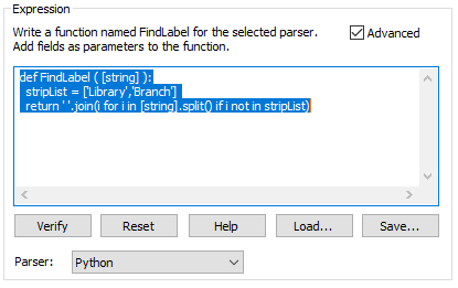

In a label expression it would be along the lines of the following and you would replace [string] with the name of your attribute:
