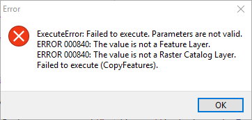

BehrouzHosseini
and now I am getting this error
curtvprice
MVP Alum
Post your current script.

curtvprice
MVP Alum
Look at the contents of "traceOut_Net" in the catalog window and modify the search expression "if "net" in str(lyr).lower()" match what you need to find.
