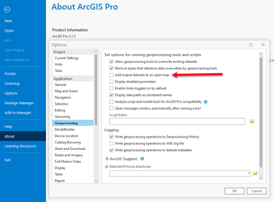

You can also config Pro to Not add the output layers to the map, then shouldn't lock them. (not tested with shapefiles).
Could also just run it standalone outside of Pro.
