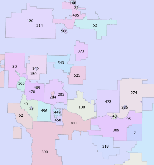

Here is what my map currently looks like.
Just the GradIDsJust the GradIDs

Any suggestions on how I can get the names and the grades to print together would be great. Thank you.
AlfredBaldenweck
MVP Frequent Contributor
lblClass.expression = '$feature.Area_Name +": " +$feature.GRADEID'
should be something like this, I think?
4 Replies
AlfredBaldenweck
ColeNelson
I tried that, and nothing happened.
ColeNelson
Whoops I typed in a field name wrong, it's working now😁
AlfredBaldenweck
Lol glad it worked.
