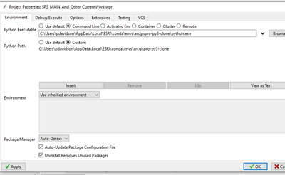

PaulDavidson1
Hi Nathan
What did you have to do to get WingWare IDE to work with Pro?  I've set the Project Properties to point to my python clone, changed the activate location,etc...  but it still seems that I am pulling arcmap versions of functions.
Thanks for any help.

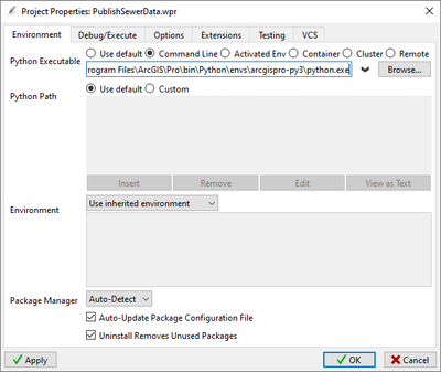

NathanHeickLACSD
Hi Paul,
I set the Python interpreter under command line.  I never tried using the Activated Env option.  Wing support might be able to get that to work for you.  I might be doing it wrong too.
Thanks,
Nathan
PaulDavidson1
Thanks Nathan
I actually had just done the same thing and finally Wing was using the latest versions of various functions.
I also set the Python Path.  I had tried this first thinking it would automatically use the correct python version but setting the command line like you did was the trick to it all working.
I have a cloned environment due to pulling the Data Loading Tools (dlt)
Thanks for that quick response.
