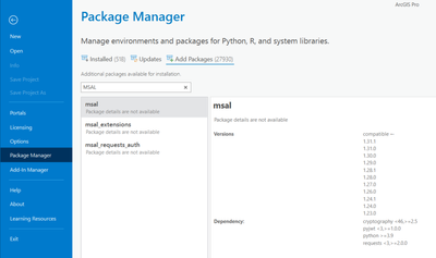

Luke_Pinner
MVP Regular Contributor
I'm using 3.3.0 and MSAL is available to install into my cloned env from the package manager UI.

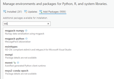

FredSpataro
Thanks Luke! That's odd, have you ever installed it before? Here's my package manager:

Luke_Pinner
Something is not right with your screenshot - you have nowhere near as many packages available (~10K vs 28K) as I do.  What does conda config --show channels output?
FredSpataro
@Luke_Pinner thanks for digging deeper on this!
What i'm seeing is not isolated to my machine... a couple of machines in my office and at least one at a client location as well but all are showing that 10K range of packages.
