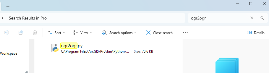

I have a script that relies on ogr2ogr, written for 3.1 and works just fine in 3.3
I'm testing 3.5 ahead of our upgrade and the script is failing, telling me that ogr2ogr cannot be imported.

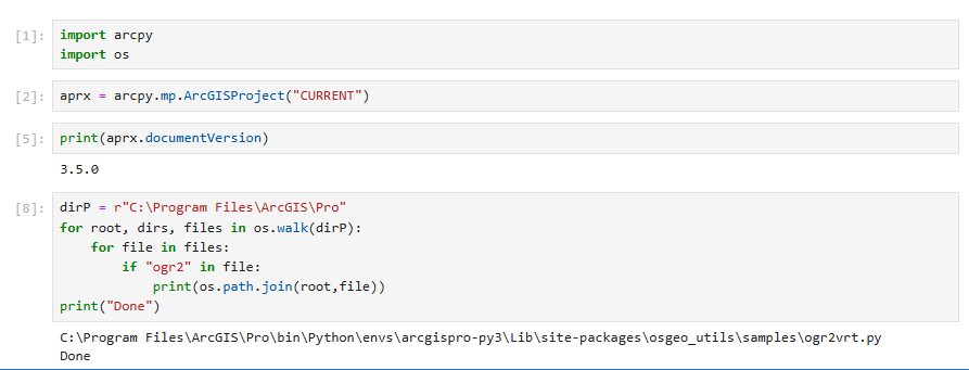

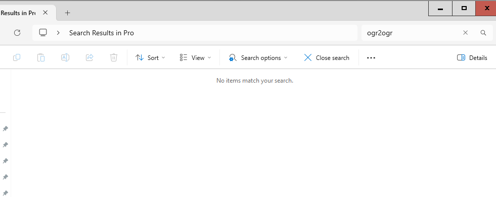

A search in file explorer (over all of Pro's ProgramFiles) shows that it just isn't there.
3.33.5
So uhhh. Where did it go? Was it renamed or something?

Yeah, ok, can absolutely confirm that ogr2ogr.exe does not exist on my 3.5 machine.
In any case, reading those linked github pages, it seems like gdal.VectorTranslate() is the way to go, which unfortunately means I need to figure out how to make that work instead. Super sucky, but hopefully it will work better than ogr2ogr?
