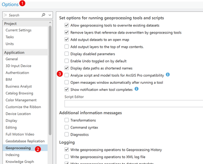

I have currently gained performance by switching off "Analyze script and model tools for ArcGIS Pro compatibility" --> Geoprocessing options—ArcGIS Pro | Documentation
This seems to run very long, but for what reason? some of my imports, my other py files?

Analyze Tools For Pro (Data Management)—ArcGIS Pro | Documentation
can be run manually and there would be little use to run it if you are only using Pro, or after a successful run the first time.
I see no point in having it as part of your default options

As my tool was written for Pro and had no ancestor from ArcMap, the "Analyze Tools For Pro" tool results in "No problems" which is good.  Is the check for compatibility a default option? If this is not activated by default on every machine, I have no problem when this runs slow.
