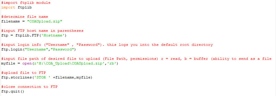

Hey guys, I wrote a script so I can post a large zipped dataset up to an FTP site, but I keep getting this return:
   File "C:/Users/wolf_ak/Desktop/Python/FTP Upload.py", line 17, in <module>
      ftp.storlines('STOR ' +filename,myfile)
   File "C:\Python27\ArcGIS10.5\lib\ftplib.py", line 497, in storlines
     raise Error("got more than %d bytes" % self.maxline)
Error: got more than 8192 bytes
Is there a workaround to this?  The file I'm trying to post will be north of 70,000 KB
Here is my code:
I appreciate any and all help.
Thank you!

Hi Austin,
Instead of ftp.storlines try ftp.storbinary.

AustinWolf
Thanks! I'll give it a shot. Everything inside of the parentheses should stay the same?
JakeSkinner
Esri Esteemed Contributor
Yes, everything in the parentheses should stay the same.
AustinWolf
That was it! You're a lifesaver!! Thanks Jake
