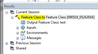

Sorry Phil...was typing from memory which can be stuck in older programs.  The Geoprocessing toolbox is where you will find the Python window option....but what I REALLY wanted to point you to is the RESULTs window under Geoprocessing.   The "save as" is if you ran it in the
After you run a script, and it is successful, you can right click on the name of the tool in the Results window and "Copy as python snippet".
This may look intimidating sometimes...but see the snippet, and what you really need (minimum) to get it to run...
