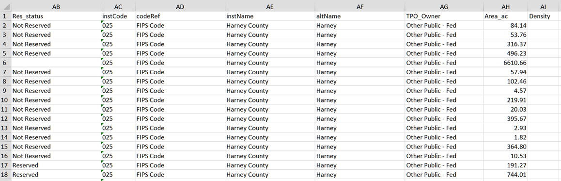

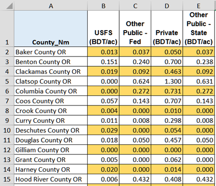

Hello GIS community,
I have a spreadsheet exported from a shapefile attribute table of Fores_Ownership_by_County for each of 4 states in the Pacific Northwest.  It is a very large spreadsheet (lots of rows), with the data representing small polys of forested area in each county. Of the many columns, there is a column for County Name (called instName below) and one for Owner Type (U.S. Forest Service, Private, State, or Non-USFS - Fed (Other Public-Fed below)).  I also have a spreadsheet listing the harvested forest biomass density for each county by ownership, see below, one for the county name and a density listed for each of the 4 ownership types. I would like to write a Python code to automate this task of looking in the density sheet for the county name and owner type, and reporting the density in the large sheet, but I am new to Python and am stuck. Any help would be appreciated. Especially if there is a way to write the program to run in GIS and populate the Forest Ownership by County attribute table directly.   Below are two snapshots of the two worksheets I am talking about:
Forest Ownership by County worksheet:
Density Worksheet:
Many thanks,
natalie

Would an attribute join not work? You may have to clean up County_Nm in your density worksheet (before you bring it into ArcMap) to fit the expected names in instName in your Forest Ownership by County table. It looks like it is going to be a 1 to many join so maybe using the tool Make Query Table (ArcGIS Help) could also be helpful.
If you want to do it in excel you can use good old MS Query (Use Microsoft Query to retrieve external data - Excel)​. But you would still need to clean up County_Nm. You just need to bring in the two tables separately and then do the join.
As you intend to make a map later on, doing it in ArcMap is probably best.

I was waiting for someone to comment on my County naming convention   There is actually another column in that big table that matches up nicely with the County_Nm in the Density table.  I really like the idea of creating a SQL query but wouldn't I have to create another Density table with one column for county, one column for TPO owner type, and one column for density to use in the query ?  I am very new to SQL and databases, but I dont believe the TPO Owner column in my large spreadsheet can reference a column heading in the Density table, where the corresponding density value is taken and applied back to the large spreadsheet.
As a side note, I was able to write a very long if-elif-else code to populate the density column, but I have to do this for 3 more states so I'd love to find a quicker way.
