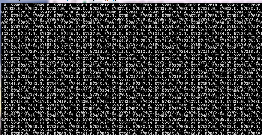

However, I am getting a "sequence size must match size of the row" error on line 10. I did not include a "myCalc" field though, as I have already added all of the necessary fields to the new table (i.e. Table_2). (Maybe I am wrong in excluding it?)
tbList = [] # empty list
for row in arcpy.da.SearchCursor('Table_1', ["FieldA"]):
    if row[0] not in tbList:
        tbList.append(row[0]) # copy distinct rows to list
inCursor = arcpy.da.InsertCursor('Table_2', ["FieldA"]) # list of all fields in new table
for row in tbList:
     inCursor.insertRow((row,None)) # field values to insert
del inCursor‍‍‍‍‍‍‍‍‍‍‍‍
If I print tbList, this is what I currently get:
