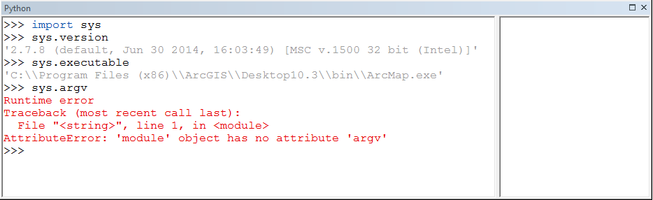

I have recently upgraded to ArcGIS 10.3 and all my script tools are not working.  For some reason, within any ArcGIS process, the built-in sys module does not have the argv attribute.  It works as expected in stand-alone.  This affects me because I use sys.argv in virtually all the script tools I have developed for my organization (70+) to pass in arguments.
For example, if I have a function like this:
def function(arg1, arg2, arg3):
    pass
It is easier to call the function and pass in parameters from a script tool like this:
function(*sys.argv[1:])
rather than:
param1 = arcpy.GetParameterAsText(0)
param2 = arcpy.GetParameterAsText(1)
param3 = arcpy.GetParameterAsText(2)
function(param1, param2, param3)

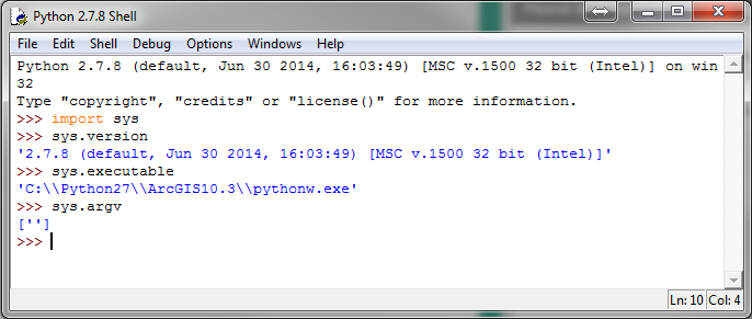

However, after the upgrade, ONLY in any ArcGIS process the sys module is lacking the argv attribute.  See pictures below:
fails in ArcGIS Python Window
and works as expected in regular IDLE shell
Is there something different about how ArcGIS is accessing Python in version 10.3?

What do you get in a Python Window with this statement?
hasattr(sys,'argv')
Regards
by Anonymous User
Not applicable
It says False.  It also does not show up as it should if I use dir(sys).  It is simply gone.

DavidWynne
Hi Caleb,
Anything else missing on sys? What does dir(sys) return?
On mine, I see
>>> dir(sys)
['__displayhook__', '__doc__', '__egginsert', '__excepthook__', '__name__', '__package__', '__plen', '__stderr__', '__stdin__', '__stdout__', '_clear_type_cache', '_current_frames', '_getframe', '_mercurial', 'api_version', 'argv', 'builtin_module_names', 'byteorder', 'call_tracing', 'callstats', 'copyright', 'displayhook', 'dllhandle', 'dont_write_bytecode', 'exc_clear', 'exc_info', 'exc_type', 'excepthook', 'exec_prefix', 'executable', 'exit', 'exitfunc', 'flags', 'float_info', 'float_repr_style', 'getcheckinterval', 'getdefaultencoding', 'getfilesystemencoding', 'getprofile', 'getrecursionlimit', 'getrefcount', 'getsizeof', 'gettrace', 'getwindowsversion', 'hexversion', 'long_info', 'maxint', 'maxsize', 'maxunicode', 'meta_path', 'modules', 'path', 'path_hooks', 'path_importer_cache', 'platform', 'prefix', 'py3kwarning', 'setcheckinterval', 'setprofile', 'setrecursionlimit', 'settrace', 'stderr', 'stdin', 'stdout', 'subversion', 'version', 'version_info', 'warnoptions', 'winver']
-Dave
