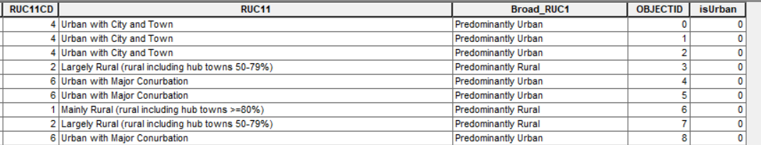

Hello!
I have a dataset containing rural-urban data that I need to process.
my code generates the isUrban field, I then need to use an update cursor to classify that field as "Rural" or "Urban" based off of the RUC11CD field (I'm currently trying to do this as a boolean), if RUC11CD is equal to or greater than "4" it needs to be classified as "Urban" (or true if i stick with boolean) . i've read the documentation on update cursors and watched some videos.
but i've been stuck for 3 days with no idea what i'm doing wrong. my cursor iterates through my table but classifies everything as false (see screenshot). my cursor code currently looks like this

# you're checking and changing fields, not row!
# if you do this, it should work:
for row in cursor:
    is_urban = row[0] > 3
    cursor.updateRow([row[0], is_urban])
# even shorter:
for row in cursor:
    cursor.updateRow([row[0], row[0] > 3])
