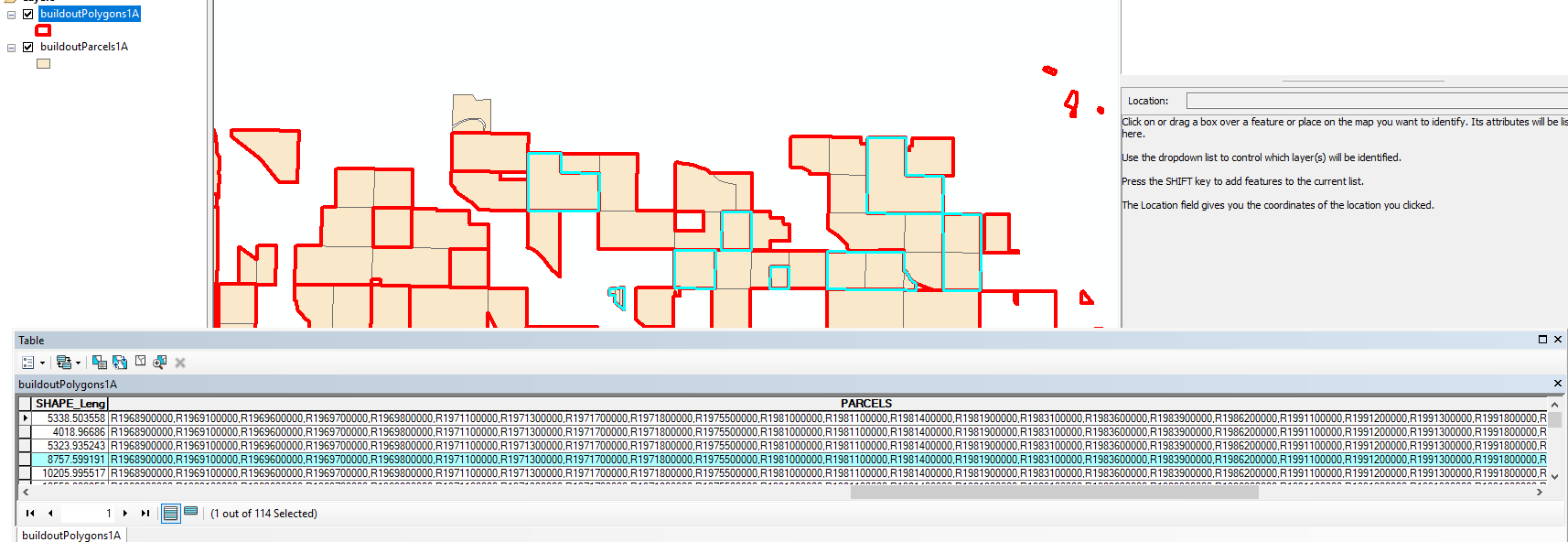

I get two different results, I first tried it your code in a stand alone script and I got something totally different than you. The first pic below is  the script  I ran Arcmap 10.6.1 python window . The second pic is the results I got when I ran it through it in 3.6.8 python, stand alone script. When I run the stand alone I noticed that the 'PAR_COUNT' doesn't get populated correctly it's OID 374 over and over.? I was able to put a print statement to print out the OID and Count but like I said it's the same count over and over. I am also confused as to why I get two different results.

2Quiker
I feel dumb, I had to make the layers "Feature Layers" to work in the stand alone script.
Thanks for all you help Randy.
