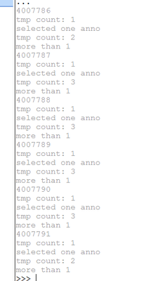

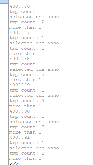

so this is to check if any annotation overlaps and if it does it rotates one by 90 degrees
this just loops through the features and works fine

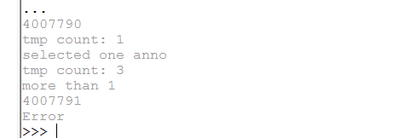

but when i add in a simple update to a text field it fails
with arcpy.da.UpdateCursor(fc, ["objectid", "FeatureID","Angle" ,"SHAPE@", "SHAPE@X", "SHAPE@Y","LEGACY_TABLE_NAME"],"objectid in (4007789,4007788,4007787,4007786,4007791,4007790)") as Cur:

StuartMoore
Hi @CodyPatterson
this is what i get:
i think the issue is with this line as it works in terms of selecting the features by their objectid and also the select by location part.
Cur.updateRow(row)
i'm running this in Desktop 10.2.1 on a versioned dataset. i'm very confident that it was working yesterday but today its being a pain...
i've used similar update cursors and its worked but this time after the first feature it seems to loose connection with the database as the features disappear from the map and this pops up:
